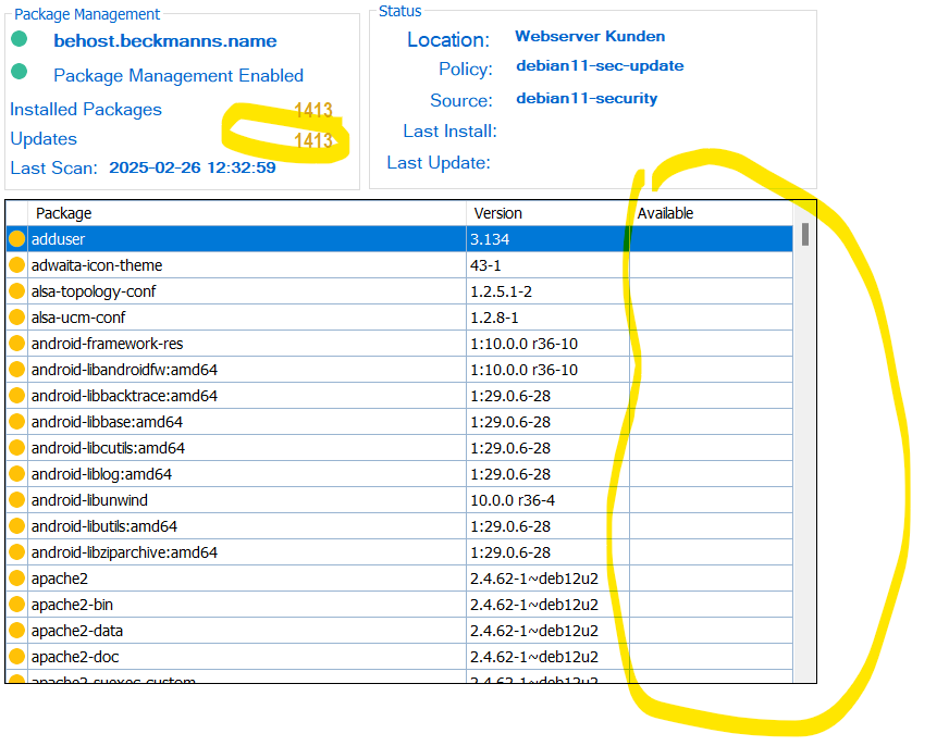

i run the scanner script - should there be the version number in the column available ?

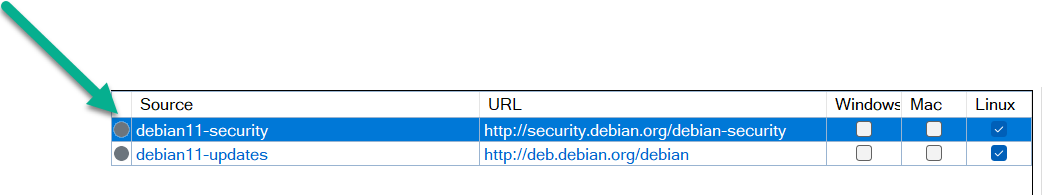

and in the list of sources, should the button be green ?
Re: Sources
By default you do not need to apply a source to your Linux distros unless you want to add a 3rd party repo to capture a LOB application or such. But yes, grey is the color of icon.
As for the updates. obviously thats not right. We need to see what was returned from the agent during the scheduled script execution on agent.

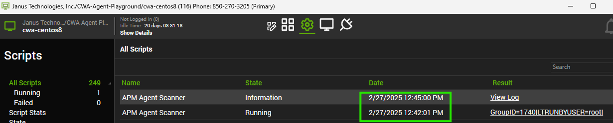

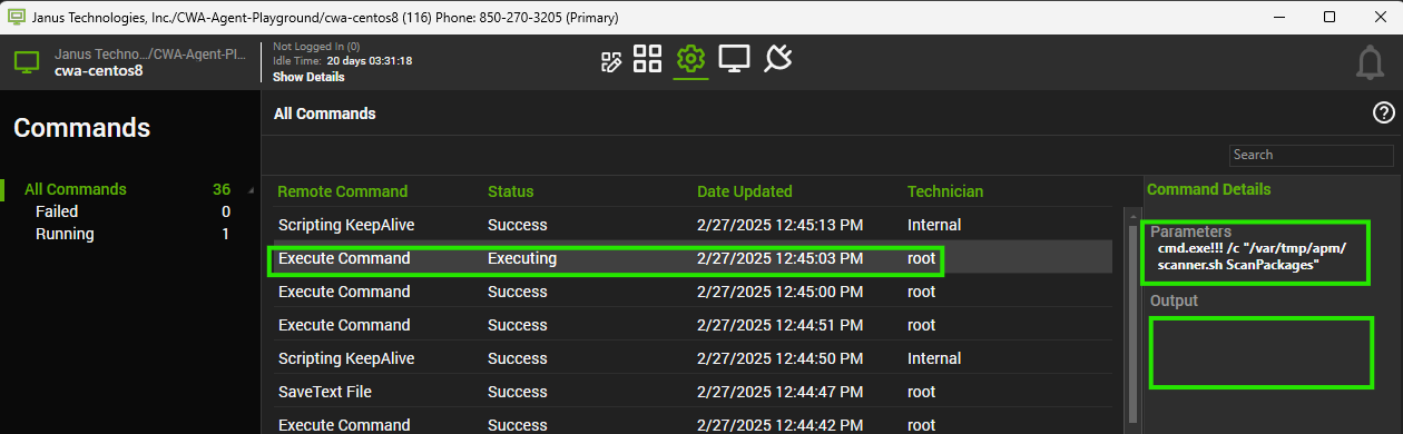

Have a look at script and command logs during the timefram of a scheduled script scan and look at what it was returning. Post a copy of that here and I can see if there was some malformation. Open up the agent in the control center and review the script logs and command logs while script was running.
Scripts Log:
Screenshot 2025-02-27 125356.png (46.22 KiB) Viewed 11523 times
Commands Log
Screenshot 2025-02-27 125451.png (80.94 KiB) Viewed 11523 times
