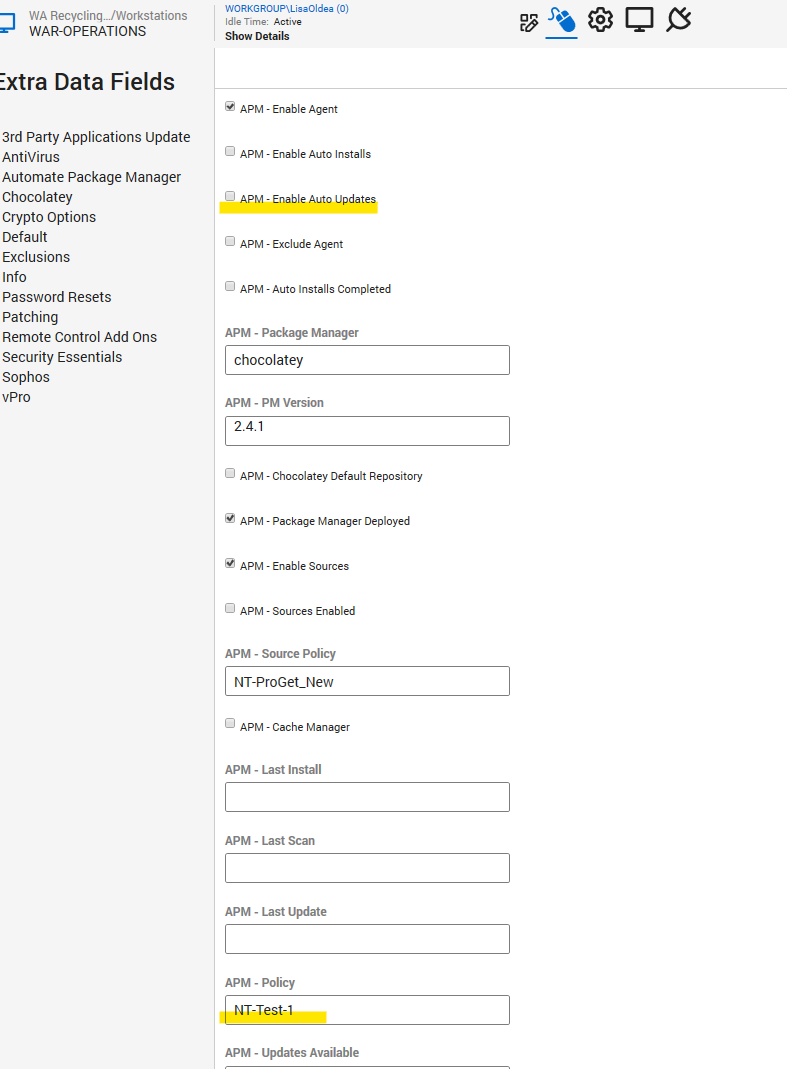

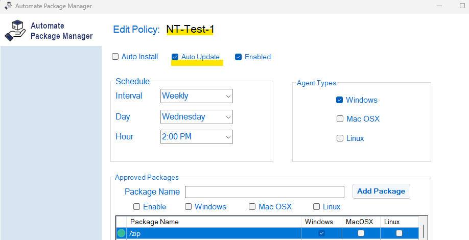

I just created a new policy with the Auto Update option enabled and assigned to a location. Noticed that the agents haven't checked the EDF "APM-Enable Auto Updates" box after the policy being applied.
Screenshot 2024-12-11 125130.png (89.09 KiB) Viewed 18267 times
Screenshot 2024-12-11 125035.png (34.63 KiB) Viewed 18267 times

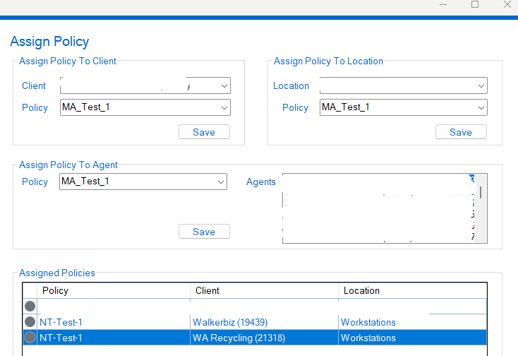

How di you apply this policy? By Client , By location or by agent? I need to know the control used to apply policy so I look in the right place fo a issue.

I have applied the policy by location.
Screenshot 2024-12-12 074320.png (23.29 KiB) Viewed 18222 times

We just posted build 1.0.0.24, we made a slight change to the enabler function for location and agent. The client enabler function had seemed to already had this change added to it. We suppect that this may be cauing your issue. We have tested in our limited environment but will look to hear back from you is this build has resolved your issue.
