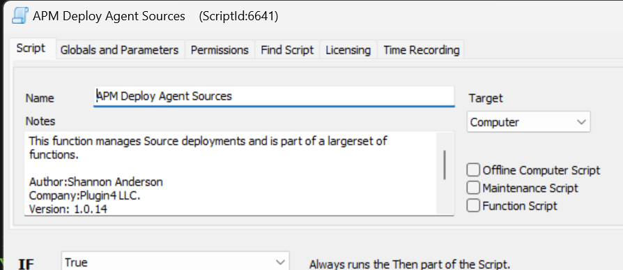

First, What version are you on?
Next is your APM Deploy Sources script at build 1.0.14?
Screenshot 2024-04-02 170809.png (76.49 KiB) Viewed 11564 times

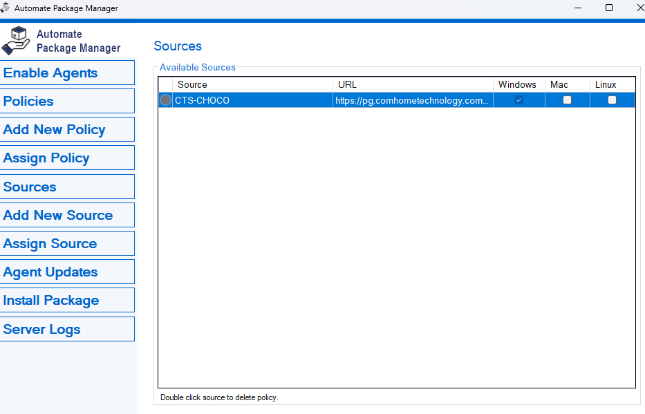

Line 47 executes this SQL, If you have a source listed in sources then this should produce a datarow.
SELECT * FROM plugin_p4a_apm_source_policy WHERE `Name` = '@SourcePolicy@' and `Windows` = '1';
Assuming the agent is windows.. Have a look at the commands that run during script time frame. These would be commands sent to agent to execute updates, scans , adding sources and such. Post any data returned by agent.
