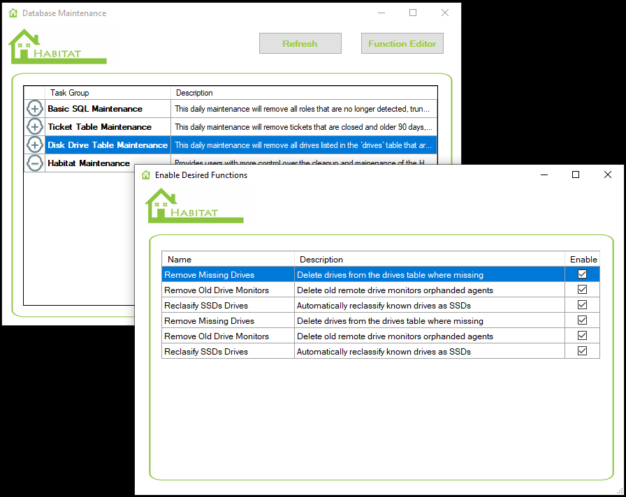

Habitat comes with a new plugin to assist you in database maintenance based on the Automate communities input.
You can enable different maintenance services that will complete daily a set of maintenance tasks. You can select to enable or disable any of the tasks and only run what you want on the database.

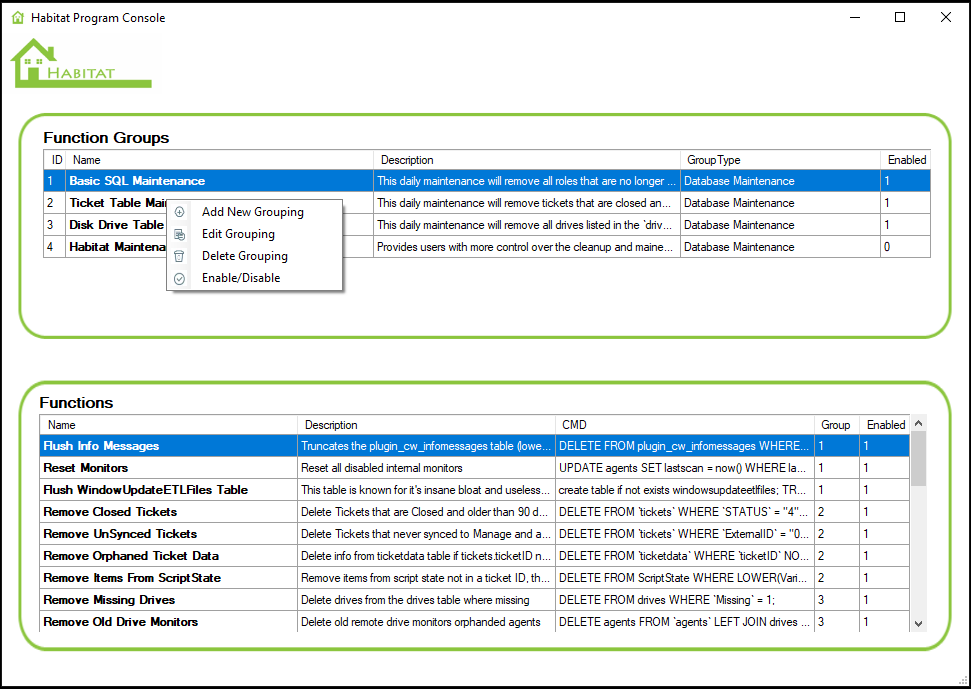

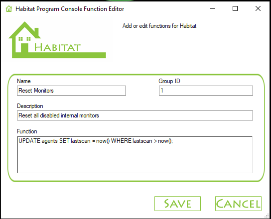

There is also access to the function editor (beta) that allows you to modify the current functions or add new ones.

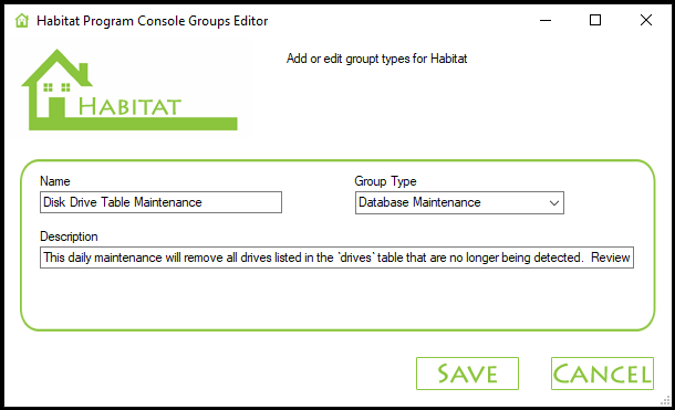

From this view you can select to manage the different function groups and functions
Currently Database Maintenance functions are integrated into Automate to execute once per day in or around 12 am.
Other function types are scheduled to be integrated into automate in the near future.
