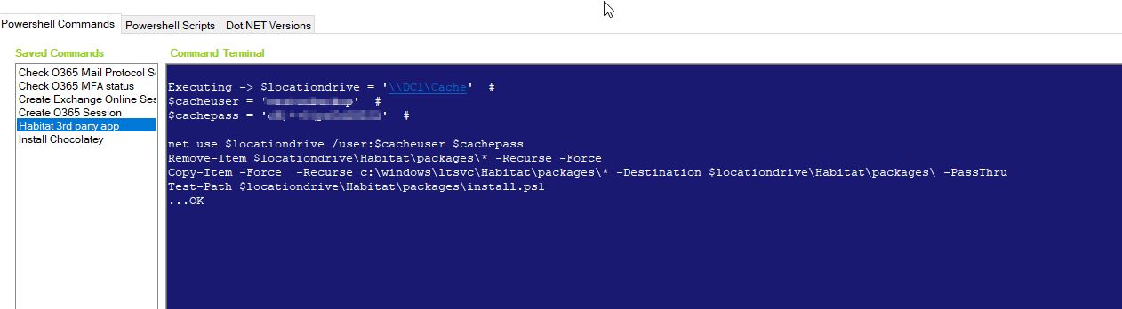

Here is the reverse of the normal agent, This is how the remote caching agent pushes files to network share. From the Habitat Powershell Console place this code in side the script section and execute. What happens?
$locationdrive = '\\myserver\myshare'  #  < -- Edit Me
$cacheuser = 'myUser'  #  < -- Edit Me
$cachepass = 'myPassword'  #  < -- Edit Me
net use $locationdrive /user:$cacheuser $cachepass
Remove-Item $locationdrive\Habitat\packages\* -Recurse -Force
Copy-Item -Force  -Recurse c:\windows\ltsvc\Habitat\packages\* -Destination $locationdrive\Habitat\packages\ -PassThru
Test-Path $locationdrive\Habitat\packages\install.ps1

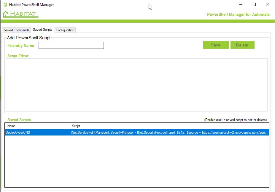

I'm not familiar with the Habitat Powershell Console. I'm assuming that it is the screenshot below?

And that I would run it on just the normal agent and not the caching agent? Also, how would I run that script? As I don't see an option to run it on a particular agent.

That's the one,
Powershell for Automate tool is a 2 part tool.
The global manager allows you to create a library of commands and scripts that can then be used against agents.

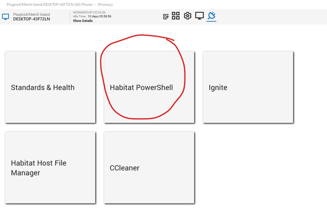

The agent console also has the interface but its to select from the library and run against any agent. See below.

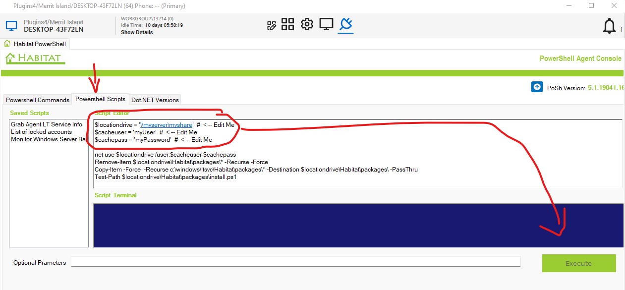

Select the Caching agent as this is the area your having problems. We want to see why the Caching agent can not copy files to network share. Once we get that solved then all other agents just read from share so are less permissive than caching agent which has to also write to network share.
In the caching agents console select the plugins menu and then the Powershell plugin execute the script.

If you added the script to the script library it will now be available in the saved scripts list. If not you can copy and paste script here and run it but it will not save for next time if needed. Thus the global POSH manager which allows you to manage and create saved scripts and one liner commands

Do not forget to edit the variables circled in red on the image above.
This should reflect your locations Shared drive setup as configured for the location the current agent is in.

I just did the powershell script and result was OK.
But I checked the shared folder and it still doesn't have any of the application package.
