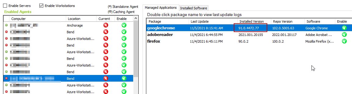

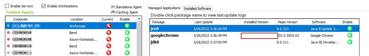

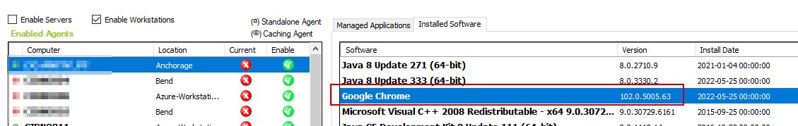

Hi, I wanted to ask for some advice as it seems that our Habitat plugin is not updating some 3rd party apps. Also reporting seems to be off, as checked in our Habitat Applications Manager, some apps are showing outdated but does have the latest version installed while some are really out of date. Check on some clients Habitat Applications Manager and it doesn't seem to detect the managed 3rd party apps are installed.

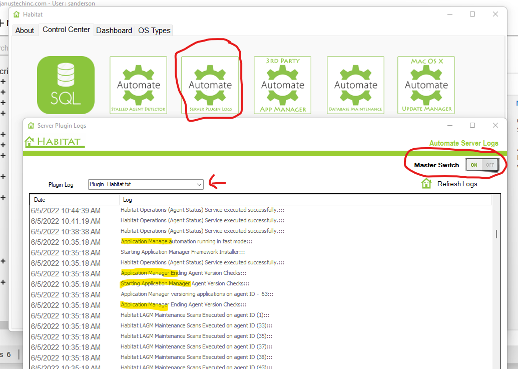

Sorry That should of been Habitat Application Manager script not Chocolatey For Automate... The two tools are very similar and do the same thing so I some time cross them when talking about them.
So once a week on that day, starting at midnight you should start seeing in the logs that automation to update the agents launches.
You can check the server logs here by pulling the Habitat log. Then check the agents script logs to see the update data on that agent.

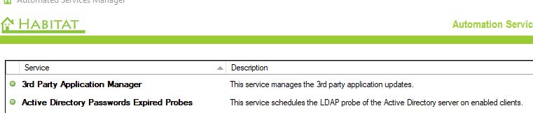

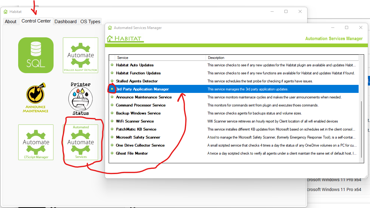

I should state that you should verify that you have the Application Manager service running.
Thanks. I checked and it is running.

- 0609.jpg (20.92 KiB) Viewed 28182 times

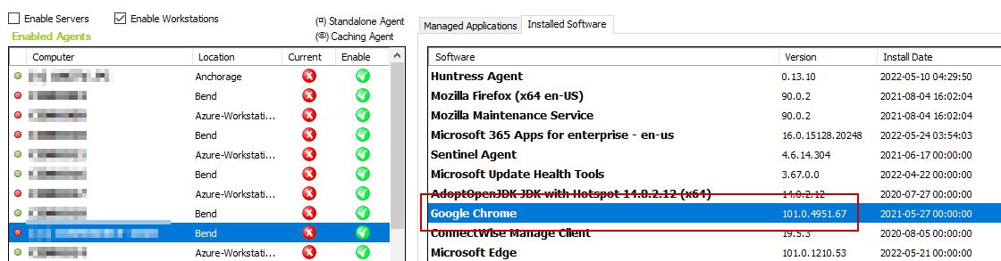

Ok so it sounds like the plugins is running as expected.
So the next question is, What is the current repo version of Google. On your cache it says its up to date so it thinks that cache repo and agent match.
Try deleting the google app from your cache folder and see what gets added back during repo updates. If the same version then its the repo behind..
If repo shows current then the caching agent is not updating repo cache locally.
This will give a direction as to what to look at next.
