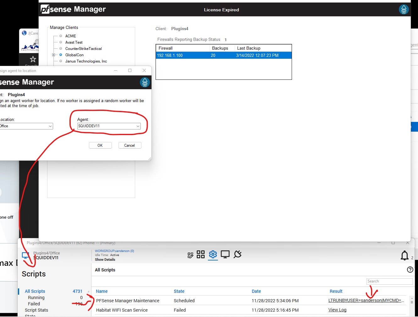

This is what it should do.
Once you have set the location and agent function for a location the firewalls under that location should get probed by the agent assigned. Below is me assigning Squiddev11 to location "office" then I executed the Scan Client function from menu and you can see that the script was scheduled on the agent that was assigned the location "Office". It was not automated but executed on demand by user "sanderson"
Screenshot 2022-11-28 173720.png (131.29 KiB) Viewed 352206 times
So things you should verify.
#1 Did you restart the DBagent after update of plugin?
There is a new table to be created and permissions need to be set by DBagent so you can save records when configuring location and agent.

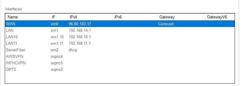

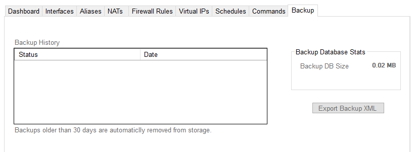

Just trying out the new version, the Dashboard and Interfaces tabs are being populated now, but all other tabs, including Backup are not.

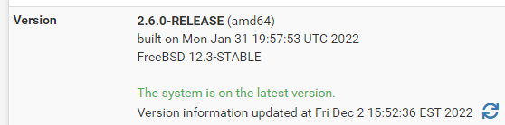

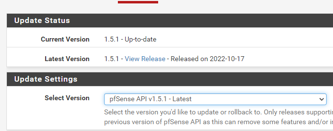

If you get a chance post some screenshots so we can see just what you are and send us the specs of you PFSense.
Hardware, version, etc. Also include API version
This will help provide a baseline for the issues.
Screenshot 2022-12-02 160218.png (12.34 KiB) Viewed 352174 times
Screenshot 2022-12-02 160158.png (13.23 KiB) Viewed 352174 times
Screenshot 2022-12-02 160128.png (44.59 KiB) Viewed 352174 times
Screenshot 2022-12-02 160103.png (3.19 KiB) Viewed 352174 times
Screenshot 2022-12-02 155600.png (29.8 KiB) Viewed 352174 times
Screenshot 2022-12-02 155523.png (17.05 KiB) Viewed 352174 times
