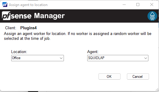

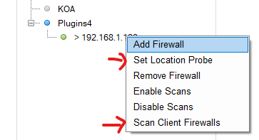

Re: Firewall Information Not Populated
Sorry for the late reply, was out on holiday.
As for your request, we have added it to the code base and it is available in build 2.0.0.2 available here
Build 2.0.0.2
What's new:
You now have 2 new items in menu. Manage what agents are used at what locations and a client scan button to allow you to force a scan now.
The set Location and agent menu item will bring you to a control that will allow you to select any location for client then any agent under that location.

Thank you, I was just checking it out, two notes:
1. The new "scan client firewall" does not seem to work
2. the execute command does not respect the new agent selection
