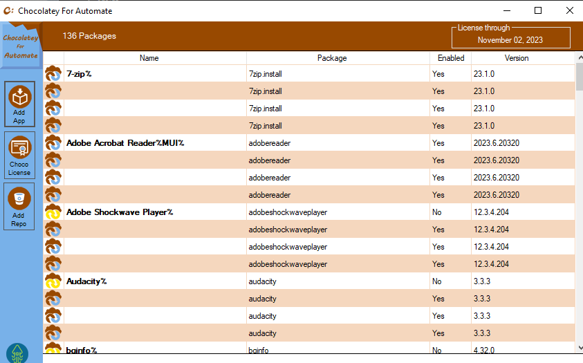

Search groups are there now, but things are broken...
Managed apps appear to have unapproved apps, and all look like they are listed twice.

Ok, looks like the scanner, when run on one of your caching managers, is not catching the package name as a primary key for that table. I'll look at that to verify we have primary key set correctly for that table.

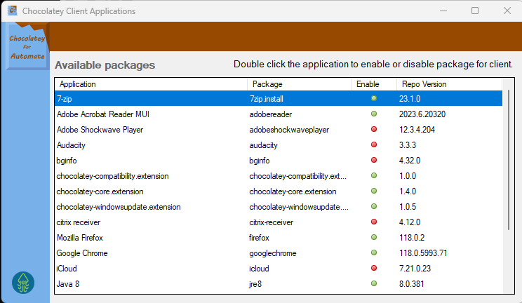

We released 3.6.0.4 this morning. We also updated the setup guide to now reflect the new Client Approved Apps list.
The global app list provides the base for all approved apps at the client level. In the Global Apps list you will want to add and enable any apps you want visible at the client level.
At the client level you will see a globally approved list of apps that are disabled for the client. Double clicking any app in list will enable/ disable app for client.

I have reviewed the main App table and it is set to have the Primary Key be the reponame (package name) of Application, This should prevent you from getting duplicates as your seeing. Your table may have not dropped as it should and is of the old 3.5 version.
I would execute this SQL and then restart the DBagent, allow a few seconds afterwards for DB agent to recreate table.
DROP TABLE If Exists plugin_p4a_chocolatey_applications;

@PL-MSTech
Yeap, and if I would of looked a bit closer to your image provided I would of seen the (%) signs beside each of the app names. This is classic 3.5 table data so you need to refresh that table and get updated table structure.
I can see this causing you issues all over the place if Applications table is not accurately configured.
