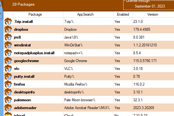

Here are Global Settings.
Global Settings
Global Settings
First, how do we set all or some of the options we see if we add a package from Installed Software (Active, Install, Update) for the global apps?
And how do we know if it is currently set to install or uninstall globally - because if we click the icon beside the package in global, it defaults to 'remove application from list' - sure, we can see if it is enabled or disabled in the table, but what about the other options (install globally, uninstall globally, update, or active... and is active the same as enabled)?

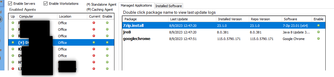

At each of the locations, I started with a scan.
The standalone is green for current and enabled, but only shows 3 managed applications....
standalone
standalone

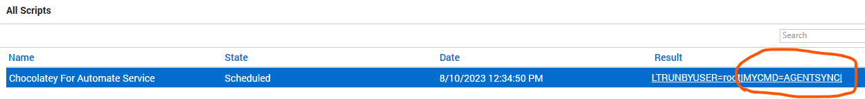

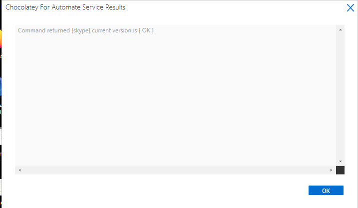

Today, for example, the first script shows this (on the site I only enabled 1 machine as standalone):
Skipping all caching services and direcly installing updates from chocolatey repository.

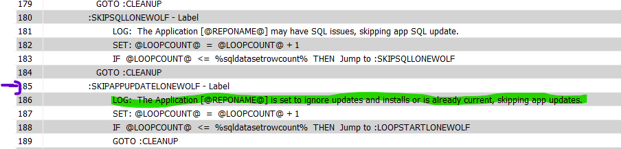

Another script shows this...
>>The Application [7zip.install] is set to ignore updates and installs or is already current, skipping app updates.
So, which is it? I'm assuming the green under 'enable' means it is set for auto updates?
The next (applicable?) script is this...
>>The Application [adobereader] is set to ignore updates and installs or is already current, skipping app updates.
Ok, so it matched it and it is current... why doesn't it show up as managed?
Next...
>>The Application [dropbox] is set to ignore updates and installs or is already current, skipping app updates.
Well, no... dropbox, as seen in global, should be set to enabled just like the others.
Next...
>>The Application [windirstat] is set to ignore updates and installs or is already current, skipping app updates.
Windirstat is not showing up in installed software... so maybe it is disabled somewhere other than where I know to look (global)?? If there is nowhere else to disable it, why is it being skipped?
And for any apps that it finds that MAY BE installed and up to date, why don't they show up in Managed Applications?
So (1)it is thinking that some apps are disabled, when they are enabled in global... and (2)installed apps not showing in Managed Apps are the first things (for now I suppose)... so I will skip past the other similar 'Information' logs and post the first 'Result' Log I come to... please let me know what I need to do before I waste another week trying to figure this out.

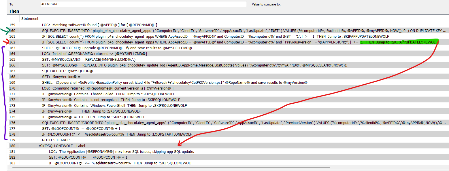

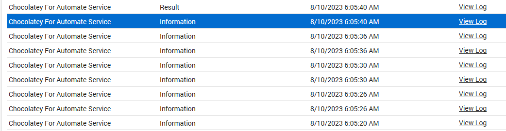

The Script(6197) was successful in the Then section.

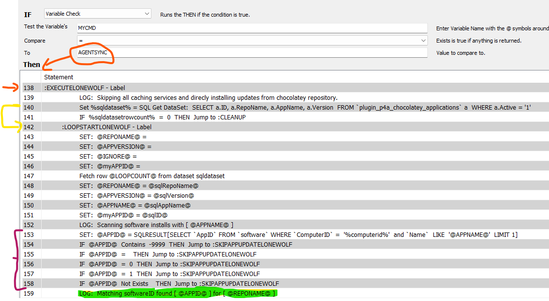

Script: S6197 - Starting at Server Time: Wednesday, August 9, 2023 1:48:50 AM
IF F5 ValueOne (P1): MYCMD Comparer (P2): 2 ValueTwo (P3): AGENTSYNC T: 1.1283859
L2 F117 Sql (P1): 'SELECT count(*) as `Suspended` FROM `plugin_p4a_chocolatey_clients` WHERE ClientID = '1' a...' T: 1.1283859
L3 F31 Control (P1): 1 T: 1.1283859
L4 F54 T: 5.1703275
L5 F139 Note (P1): This section reserved for secondary agents to sync with the current location cache. T: 13.2016893
L6 F20 SetType(P1):11 Parameter(P2):'SELECT count(ComputerID) FROM ...' VariableName(P3):LONEWOLF T: 13.2016893
L7 F114 File (P1): 'C:\ProgramData\chocolatey\choc...' Check (P2): 1 Jump (P3): :CHOCOINSTALL T: 13.2016893
L8 F139 Note (P1): :STARTSYNCSERVICE T: 15.2117621
L9 F20 SetType(P1):1 Parameter(P2):'C:\ProgramData\chocolatey\bin\...' VariableName(P3):CHOCOINST T: 15.2128381
L10 F20 SetType(P1):1 Parameter(P2):'C:\ProgramData\chocolatey\choc...' VariableName(P3):CHOCOEXE T: 15.2128381
L11 F20 SetType(P1):1 Parameter(P2):1 VariableName(P3):LOOPCOUNT T: 15.2128381
L12 F90 File (P1): %ltsvcdir%\Chocolatey\GetPKGVersion.ps1 T: 15.2128381
L13 F70 Value (P1): LONEWOLF Comparer (P2): 2 To (P3): 1 Jump (P4): :EXECUTELONEWOLF T: 21.2392683
L138 F139 Note (P1): :EXECUTELONEWOLF T: 21.2392683
L139 F29 Message (P1): Skipping all caching services and direcly installing updates from chocolatey repository. T: 21.2392683
L140 F196 SQL (P1): 'SELECT a.ID, a.RepoName, a.AppName, a.Version FROM `plugin_p4a_chocolatey_applications` a...' T: 21.2392683
L141 F70 Value (P1): 12 Comparer (P2): 2 To (P3): 0 Jump (P4): :CLEANUP T: 21.2392683
L142 F139 Note (P1): :LOOPSTARTLONEWOLF T: 21.2392683
L143 F20 SetType(P1):1 Parameter(P2): VariableName(P3):REPONAME T: 21.2392683
L144 F20 SetType(P1):1 Parameter(P2): VariableName(P3):APPVERSION T: 21.2392683
L145 F20 SetType(P1):1 Parameter(P2): VariableName(P3):IGNORE T: 21.2392683
L146 F20 SetType(P1):1 Parameter(P2): VariableName(P3):myAPPID T: 21.2392683
L147 F197 Variable (P1): sqldataset RowIndex (P2): 1 T: 21.2392683
L148 F20 SetType(P1):1 Parameter(P2):7zip.install VariableName(P3):REPONAME T: 21.2392683
L149 F20 SetType(P1):1 Parameter(P2):23.1.0 VariableName(P3):APPVERSION T: 21.2392683
L150 F20 SetType(P1):1 Parameter(P2):7-zip% VariableName(P3):APPNAME T: 21.2392683
L151 F20 SetType(P1):1 Parameter(P2):1 VariableName(P3):myAPPID T: 21.2392683
L152 F29 Message (P1): Scanning software installs with [ 7-zip% ] T: 21.2392683
L153 F20 SetType(P1):11 Parameter(P2):'SELECT `AppID` FROM `software`...' VariableName(P3):APPID T: 21.2392683
L154 F70 Value (P1): APPID Comparer (P2): 8 To (P3): -9999 Jump (P4): :SKIPAPPUPDATELONEWOLF T: 21.2392683
L155 F70 Value (P1): APPID Comparer (P2): 2 To (P3): Jump (P4): :SKIPAPPUPDATELONEWOLF T: 21.2469282
L156 F70 Value (P1): APPID Comparer (P2): 2 To (P3): 0 Jump (P4): :SKIPAPPUPDATELONEWOLF T: 21.2469282
L157 F70 Value (P1): APPID Comparer (P2): 2 To (P3): 1 Jump (P4): :SKIPAPPUPDATELONEWOLF T: 21.2469282
L158 F70 Value (P1): APPID Comparer (P2): 1 To (P3): Jump (P4): :SKIPAPPUPDATELONEWOLF T: 21.2469282
L159 F29 Message (P1): Matching softwareID found [ 42651472 ] for [ 7zip.install ] T: 21.2469282
L160 F67 Sql (P1): 'INSERT INTO `plugin_p4a_chocolatey_agent_apps`(`ComputerID`,`ClientID`,`SoftwareID`,`AppAs...' T: 21.2469282
L161 F117 Sql (P1): 'SELECT count(*) FROM plugin_p4a_chocolatey_agent_apps WHERE AppAssocID = '1' and ComputerI...' T: 21.2469282
L162 F117 Sql (P1): 'SELECT count(*) FROM plugin_p4a_chocolatey_agent_apps WHERE AppAssocID = '1' and ComputerI...' T: 21.2469282
L185 F139 Note (P1): :SKIPAPPUPDATELONEWOLF T: 21.2469282
L186 F29 Message (P1): 'The Application [7zip.install] is set to ignore updates and installs or is already current...' T: 21.2469282

When a script is scheduled on an agent it is passed a parameter, you can see this parameter in the script schedule log. This allows us to see what function in script is being called. We can then go into this script and follow the logic through the script function.

A typical script run should look like so:
Screenshot 2023-08-10 105502.png (64.69 KiB) Viewed 282788 times
If you select the view log link then it reports status of package its working on.
Screenshot 2023-08-10 105604.png (9.34 KiB) Viewed 282788 times

When we come into script at line 1 we query database to see if agent is caching or standalone (lonewolf) and if lonewold we jump to line 138 {executelonewolf} which brings us to the following image.
Screenshot 2023-08-10 112425.png (67.39 KiB) Viewed 282775 times
On line 140 we query for all enabled approved packages from global list and on line 142 we start looping through each result we received. So from line 142 on we will see this loop repeat for each package we have in query. We define and then set several data values from SQL query into script variables before proceeding . This is done on line 143 through 152.
Now that we have all the data sorted for one package in the loop we test that packages "app name" against the agents known installed software list. This is a list that automate has generated from probing the Installed software on agent. If we get a hit on query then the APPID will be some number above the number one which means we have a natively installed software for Chocolatey to try and manage. You will note that I said try to manage, I will give some reason why this may fail a little later. So lines 153 to 158 tests the APPID to make sure it is valid. If valid and matching it will LOG that it found software in line 159 and move on to line 160 else if invalid (not found) it will skip trying to "update" a non existent package.
Screenshot 2023-08-10 114436.png (102.54 KiB) Viewed 282775 times
At line 160 we try to insert the new found application for the agentID into the database and if it already exists we update that record. Next we query the same record and test to see if previous version and current version are the same.
If versions differ then if will fail the two tests and will continue to line163 where we execute the chocolatey update and complete the blending of Chocolatey app with a pre-existing app installed outside of Chocolatey.
The the loop continues repeating these steps until all approved packages are delt with.
In your logs it looks to be hitting the line 162 were versions are tested and they are equal. This causes a jump to line 185 that logs the skip and tests to see if loop should continue.

So in the logs you supplied we are see what looks to be several packages being skipped as they are already "installed" and are up to date. This also means they should exist as entries in plugin_p4a_chocolatey_agent_apps table in the database with values (`ComputerID`,`ClientID`,`SoftwareID`,`AppAssocID`,`LastUpdate`,`PreviousVersion`).

Ok... this look correct?
choco extensions
choco extensions
So, I am assuming that if it has already been installed, this will update or overwrite the current version and keep it current?
Thank you!
