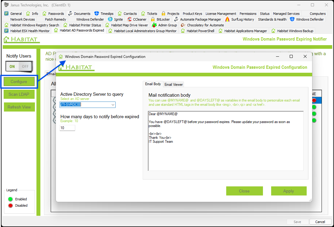

Using the configure button:
Select from available Domain controllers in the list provided. If no domain controllers are listed then we are not seeing any Windows Active Directory servers for that client.
How many days to notify before expired? This sets the numbers of days before the users password expires that the automated service should send the given email to user.
The LDAP directory root is not required, the scanner will find the root domain and search for all users in the available OU's
The email body is where you can craft a HTML based email that will be used to let the user know the passwords about to expire. You can put in any HTML code you like and then use the email viewer to see how it will appear to the users. We have 2 master variables you can add to your email ( @MYNAME@ and @DAYSLEFT@ ). These 2 variables allow you to dynamically embed the current name of the user and their number of days left so that emails are personalized to the user receiving them.

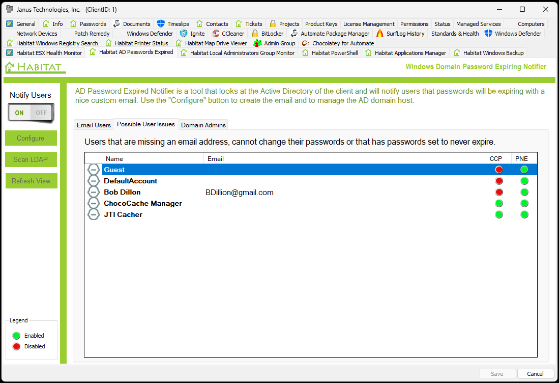

User Issues
User that can not have email notifications sent to them are listed here. User will have "Cannot Change Password" enabled, "Password Never Expires" is enabled, or the user is missing the "Email " property not set to a email address.

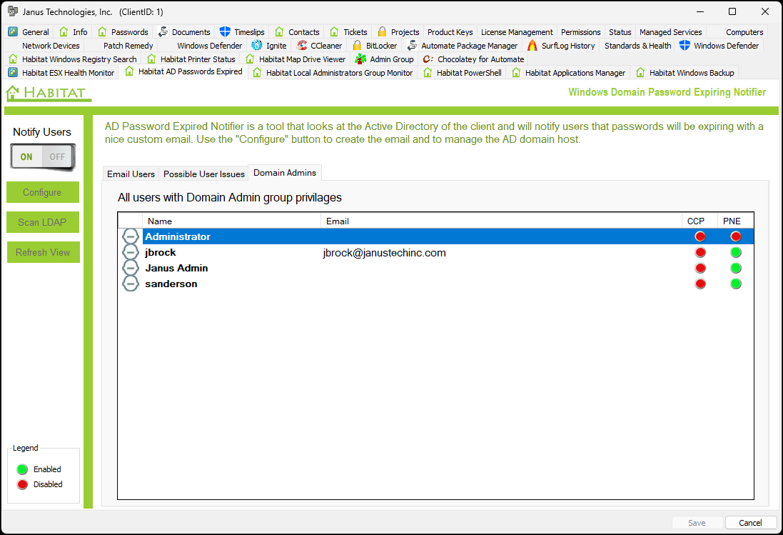

Domain Admins
The Domain Admins view displays all users that are a member of the domain admins group. The domain admins may have "Cannot Change Password" enabled, "Password Never Expires" is enabled, or the domain admin maybe missing the "Email " property.
