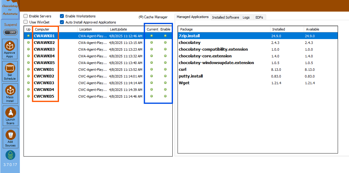

We have several new little tweaks made to the data views where sorting on image columns failed. We've made a custom sort function to manage these columns.
Screenshot 2025-04-08 122321.png (69.25 KiB) Viewed 18592 times

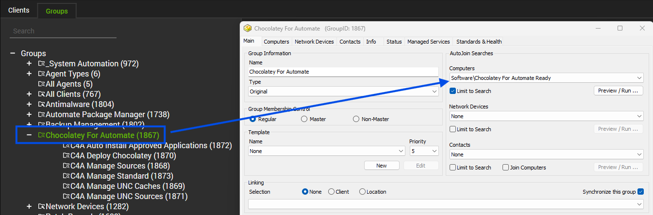

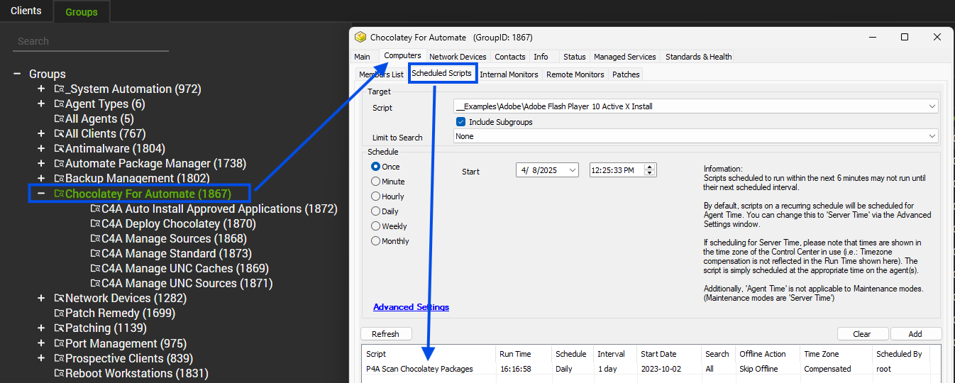

We had several reports of groups not having a search or script assigned which is causing functions not to be performed. If anyone thinks something is off or not working as desired can have a quick peek at the groups and sub groups and verify that each group has a valid search assigned and a Scheduled script enabled.
Group Seach Exists?
Screenshot 2025-04-08 122526.png (106.68 KiB) Viewed 18592 times
Group Script Exists?
Screenshot 2025-04-08 122642.png (143.43 KiB) Viewed 18592 times

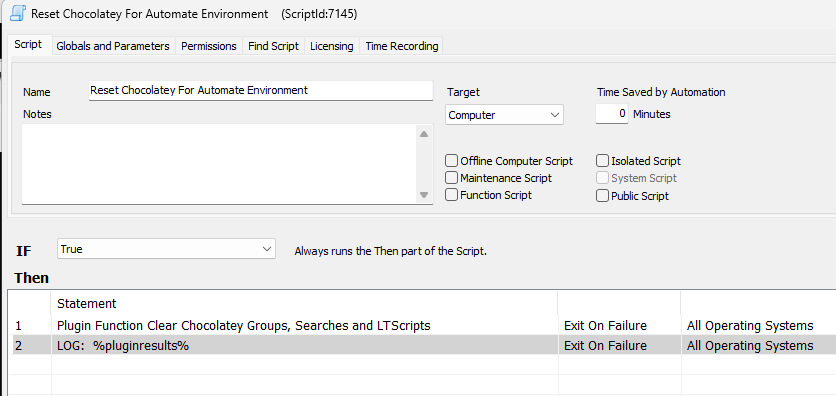

If any group is missing either of these items then you should reset your Chocolatey For Automate environment. Here is how you do that.
Create a Simple 2 line script
We named our script "Reset Chocolatey For Automate Environment" and added 2 lines. The Plugin Server Function and a log line to log any output.
Screenshot 2025-04-08 124335.png (25.19 KiB) Viewed 18592 times

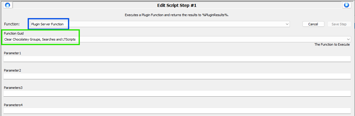

The Plugin Server Function looks like this:
Screenshot 2025-04-08 124424.png (17.23 KiB) Viewed 18592 times
Once script is created, You can execute the script using any agent, just one and you only need to run it once. After the script finishes restart the DBagent and allow several minutes for the DBagent to complete its start up tasks, which include recreating groups, searches and scripts.
