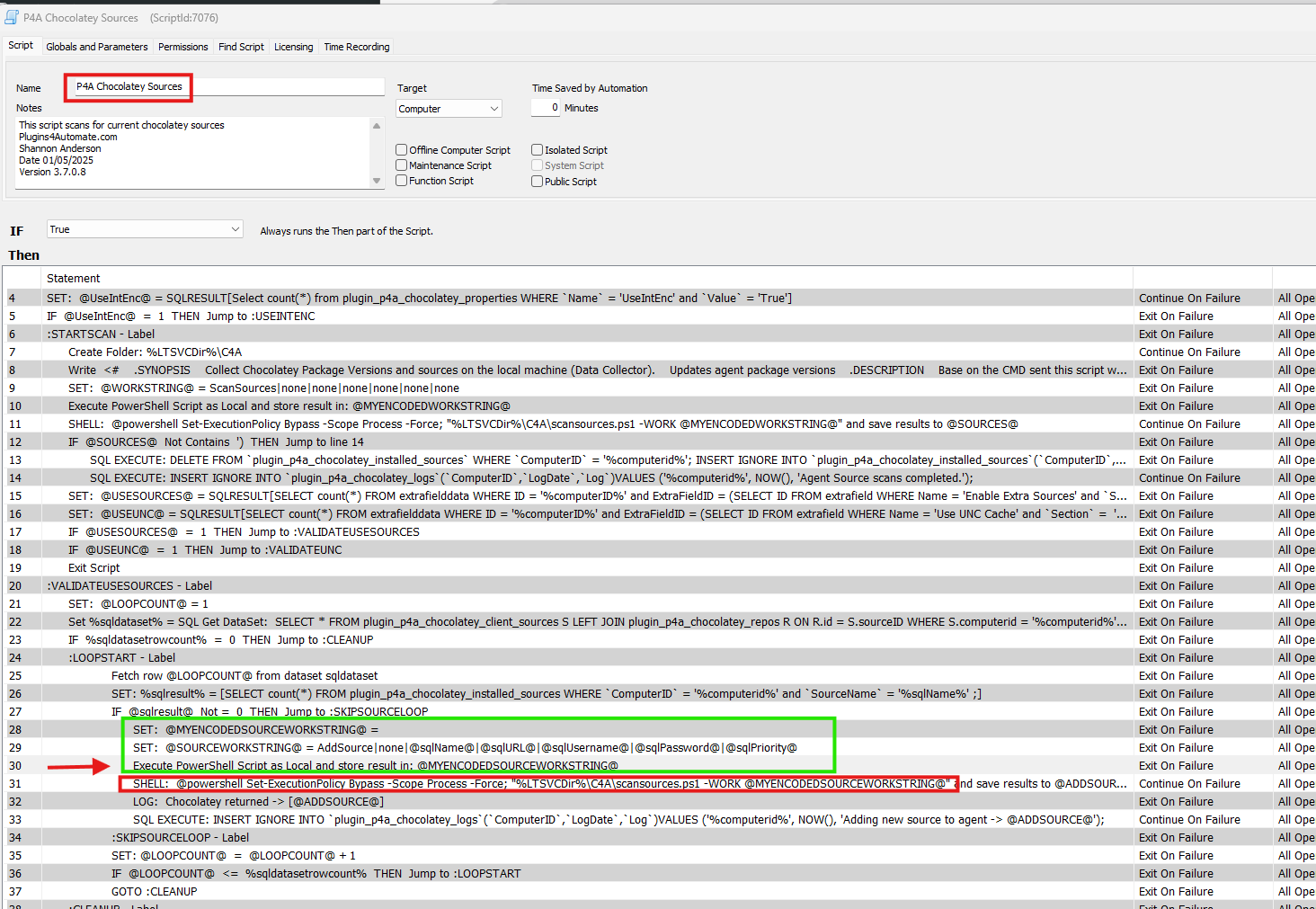

The only way I could see that is if line 30 failed to convert line 29 in to a base64 string. Line 28 sets the WORK string to blank, Line 29 is the string we are going to convert and send. So it would only make since that this was the failure point and nothing was returned form Base64 request.

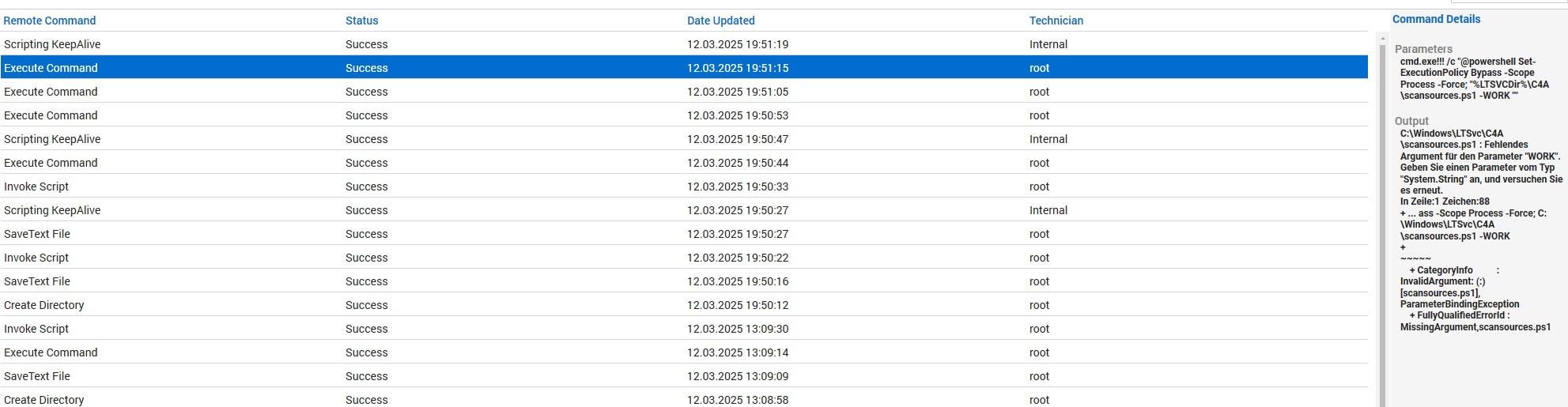

These are the commands which i can see, when i started the Script
the error ist on the last execute command
here the output of the first two execute command lines (i changed host and password)

param(
      [Parameter(Mandatory = $true)]
      [string]
      $WORK
    try{
        $args = [System.Text.Encoding]::UTF8.GetString([System.Convert]::FromBase64String($WORK))
        $workdata = $args.Split("|")
        $CMD = $workdata[0]
        $package = $workdata[1]
        $sourcename = $workdata[2]
        $sourceURL = $workdata[3]
        $username = $workdata[4]
        $password = $workdata[5]
        $priority = $workdata[6]
Further down the code we have the function to add source
function addSourceRepo{
    try{
        if($username -eq ""){
            $xc = c:\programdata\chocolatey\bin\choco.exe source add -n="'$sourcename'" -s="'$sourceURL'" --priority="'$priority'"
            write-output $xc
        }else{
            $xc = c:\programdata\chocolatey\bin\choco.exe source add -n="'$sourcename'" -s="'$sourceURL'" -u="'$username'" -p="'$password'" --priority="'$priority'"
            write-output $xc
    }catch{
        return
Lastly the actual code that run s just a few short lines.
if($CMD -eq "ScanPackages"){
    scan-packages
}elseif($CMD -eq "ScanSources"){
    scan-sources
}elseif($CMD -eq "AddSource"){
    addSourceRepo
}elseif($CMD -eq "RemoveAllSources"){
    removeAllSources
}elseif($CMD -eq "RemoveSource"){
    $xc = c:\programdata\chocolatey\bin\choco.exe source remove -n="'$sourcename'"
}else{
    write-output "Command not found"
So starting at the top, We take in a base64 encryptrd string called WORK, Work is then decoded to a normal string "AddSource|none|MyName|MyURL|MyUsername|mypass|0" and then split in the pipe key ( | ) in to an array and then assigned a variable name for each value.
We test the CMD variable (in this case is AddSource) which launches the addSourceRepo function above. That function takes your data and adds the repo to chocolatey as seen in function.
If $xc = Output ->(4693','25','chocolatey','https://community.chocolatey.org/api/v2/','0')
Then I'm thinking this was a scanSource and not an addSource command.
Ths is plausable as we do send a scan request first, so we need to see if we get inside the look of the Automate script where we test for and add sourcers.

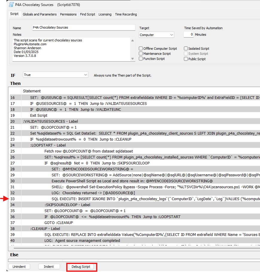

Please try running scrit in debug mode on the agent in question. Place a break at line 33 so script runs through the loop once and stops. Then lets look at script and command logs, we have a script log line that will print out "Chocolatey returned -> [@ADDSOURCE@]" in the agents script logs.
Did we get the log, did it stop at the break point if so post the log and the command input/output.
Screenshot 2025-03-12 165205.png (82.47 KiB) Viewed 25862 times

i have to manually set
UseintEnc to 0 to make the script run to validatesources
line 32 logs:
Chocolatey v2.4.3
Added chocorepo - http://host:8080/nuget/chocopublic/ (Priority 5)
%sqldatasetrowcount%=1
then script exits in cleanup

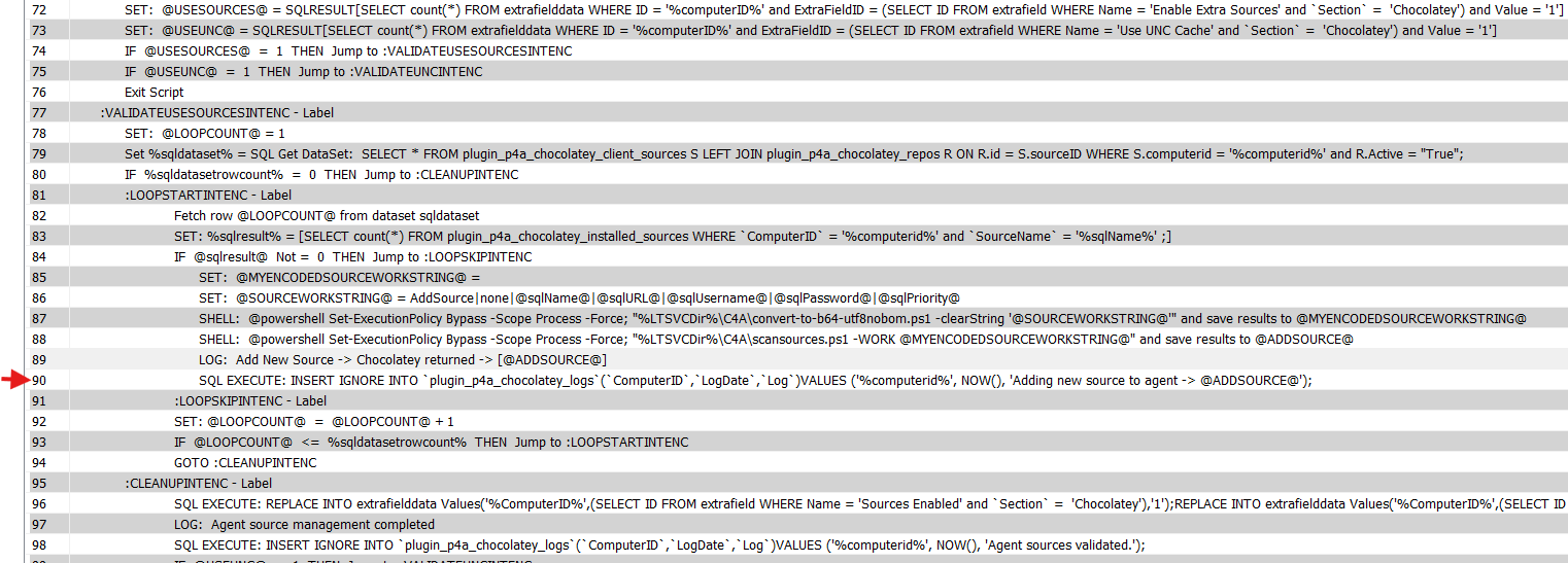

On line 4 we set that value so you must have it set in the main console.
Ok lets try this, If you have the Use International Encoding selected, Run script in debug and place a break at line 90.
Screenshot 2025-03-13 105318.png (80.64 KiB) Viewed 25569 times
I was in the wrong area of script for your encoding selection. This is the loop that you should be in.
If you are using the same agent to test, then remove the source if it exists on agent first before running debug test.

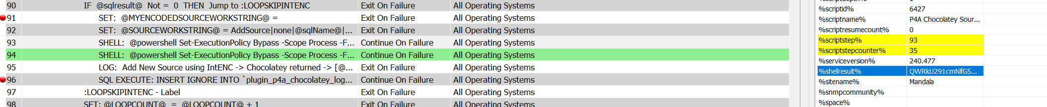

Problem seems to be in Line
there is a shellresult, which looks like the encoded string, but
@myencodedsourceworkstring@ ist empty
so that line 94 gives the error
this is sourceworkstring:
AddSource|none|chocorepo|http://host.de:8080/nuget/chocopublic/| ... password|5
