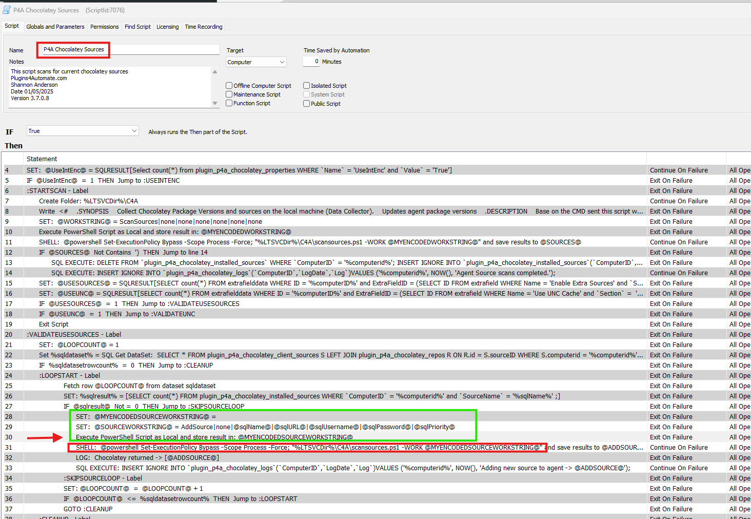

Re: scansources.ps1 error
Sorry had to go translate that.
So error is saying that no data was passed along with the -WORK option.
The only way I could see that is if line 30 failed to convert line 29 in to a base64 string. Line 28 sets the WORK string to blank, Line 29 is the string we are going to convert and send. So it would only make since that this was the failure point and nothing was returned form Base64 request.

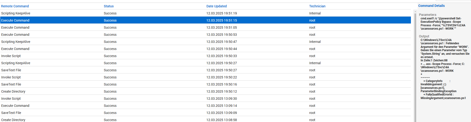

These are the commands which i can see, when i started the Script
the error ist on the last execute command
here the output of the first two execute command lines (i changed host and password)
1.
cmd.exe!!! /c "@powershell Set-ExecutionPolicy Bypass -Scope Process -Force; "%LTSVCDir%\C4A\convert-to-b64.ps1 -clearString 'AddSource|none|chocorepo|http://proget.host.de:8080/nuget/chocop ... password|5'"
Output:
QWRkU291cmNlfG5vbmV8Y2hvY29yZXBvfGh0dHA6Ly9wcm9nZXQubWFuZV0L2Nob2NvcHV3xjaG9jbxNYW5kYWxhMjAyNSMzfDU=
2. cmd.exe!!! /c "@powershell Set-ExecutionPolicy Bypass -Scope Process -Force; "%LTSVCDir%\C4A\scansources.ps1 -WORK U2NhblNvdXJjZXN8bm9uZXxub25lfG5vbmV8bm9uZXxub25lfG5vbmU=""
Output:

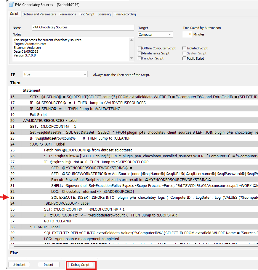

Please try running scrit in debug mode on the agent in question. Place a break at line 33 so script runs through the loop once and stops. Then lets look at script and command logs, we have a script log line that will print out "Chocolatey returned -> [@ADDSOURCE@]" in the agents script logs.
Did we get the log, did it stop at the break point if so post the log and the command input/output.
Screenshot 2025-03-12 165205.png (82.47 KiB) Viewed 25855 times

i have to manually set
UseintEnc to 0 to make the script run to validatesources
line 32 logs:
Chocolatey v2.4.3
Added chocorepo - http://host:8080/nuget/chocopublic/ (Priority 5)
%sqldatasetrowcount%=1
then script exits in cleanup

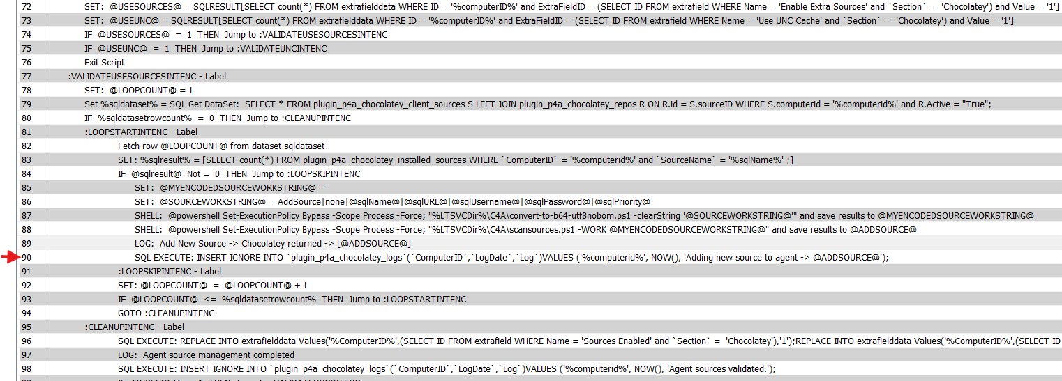

Ok lets try this, If you have the Use International Encoding selected, Run script in debug and place a break at line 90.
Screenshot 2025-03-13 105318.png (80.64 KiB) Viewed 25562 times
I was in the wrong area of script for your encoding selection. This is the loop that you should be in.
If you are using the same agent to test, then remove the source if it exists on agent first before running debug test.
P.s do not mind that my script image does not look like your script entirly. I am making some modifications to the script to improve it just a little and adding some more logging.

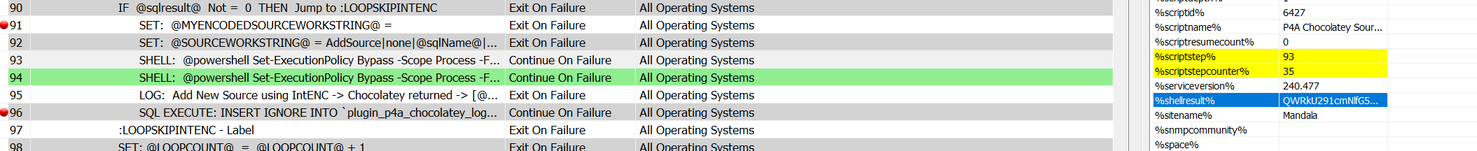

Problem seems to be in Line
there is a shellresult, which looks like the encoded string, but
@myencodedsourceworkstring@ ist empty
so that line 94 gives the error
this is sourceworkstring:
AddSource|none|chocorepo|http://host.de:8080/nuget/chocopublic/| ... password|5
