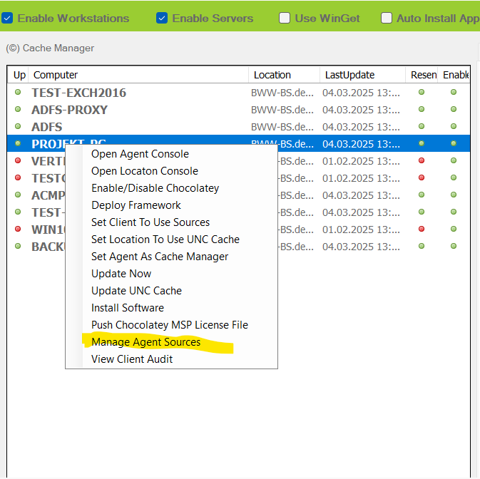

I am trying the new application manager in habitat 01.49
i have no extra source globally defined and so nothing is assigned
I tried some things and it worked but then i accidentally removed the source
in manage agent sources
managed sources.png (47.22 KiB) Viewed 13583 times
now the agents do not find any package
i tried reset sources - but no success
what can i do ?

after install of habitat .50 there were the repositories in the manage Agent sources Windows.
But then they were gone again. I had to click reset sources and now everything is fine again.
But next Problem:
I added a proget caching server as Global Repo and it is active.
i did a "Set Client to use Sources" but no extra Repor Agent sources Windows
Should I see the new repo in Agent sources Windows ?
or
Do i have to assign the new repo manually ?

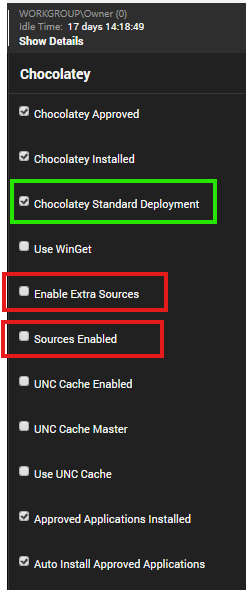

You can aways tell if an agent is set to use sources by looking at its EDFs
Screenshot 2025-03-11 143119.png (27.28 KiB) Viewed 11678 times

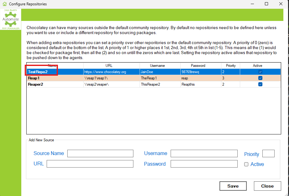

Next add a new source:
Screenshot 2025-03-11 143409.png (43.83 KiB) Viewed 11678 times

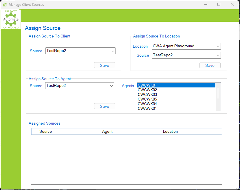

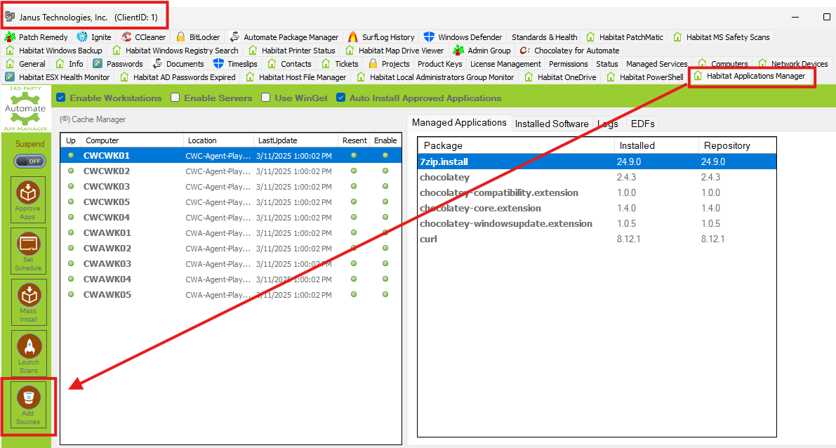

Goto Client's console - Habitat Application Manager tab, Select the assign Sources button:
Screenshot 2025-03-11 144248.png (109.7 KiB) Viewed 11678 times
Then assign the source to Client, Location or agent.
Screenshot 2025-03-11 143509.png (37.65 KiB) Viewed 11678 times
If you check EDFs for agent then "Use Sources" will now be checked and Sources Enabled and Use Standard deployment may or may not be checked based on where in the progress the agent is. Sources are set based on group membership.
