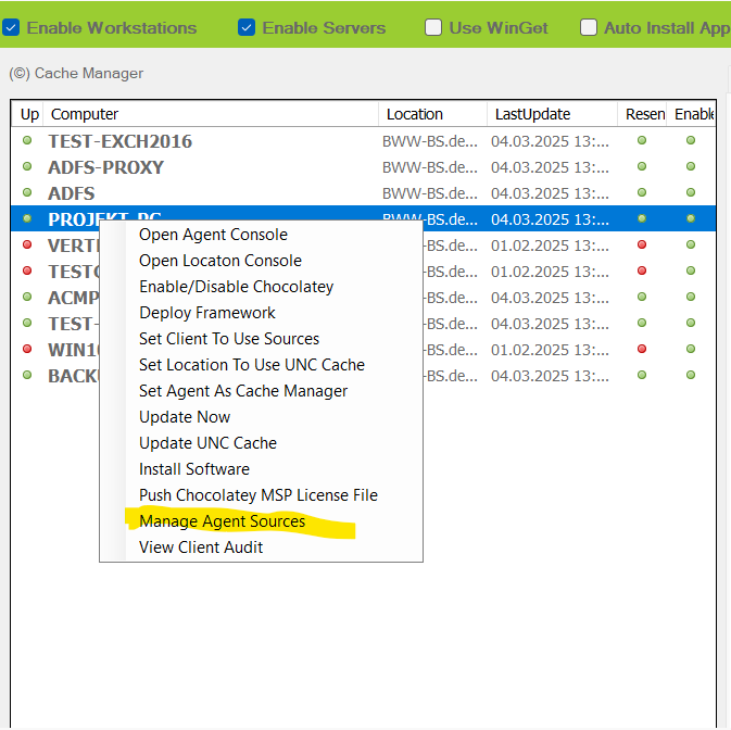

I am trying the new application manager in habitat 01.49
i have no extra source globally defined and so nothing is assigned
I tried some things and it worked but then i accidentally removed the source
in manage agent sources
managed sources.png (47.22 KiB) Viewed 13574 times
now the agents do not find any package
i tried reset sources - but no success
what can i do ?

after install of habitat .50 there were the repositories in the manage Agent sources Windows.
But then they were gone again. I had to click reset sources and now everything is fine again.

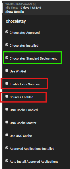

You can aways tell if an agent is set to use sources by looking at its EDFs

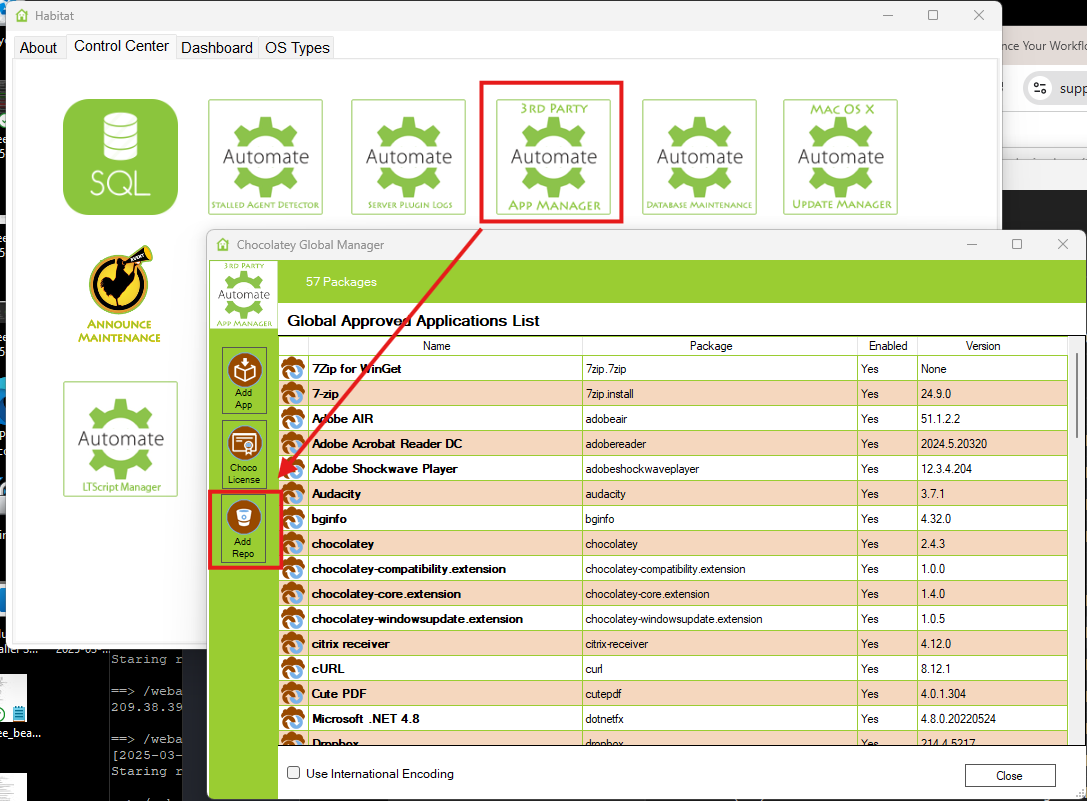

To set a source for one or more agents:
First goto Main Tool View and select sources:
Screenshot 2025-03-11 143318.png (166.55 KiB) Viewed 11669 times

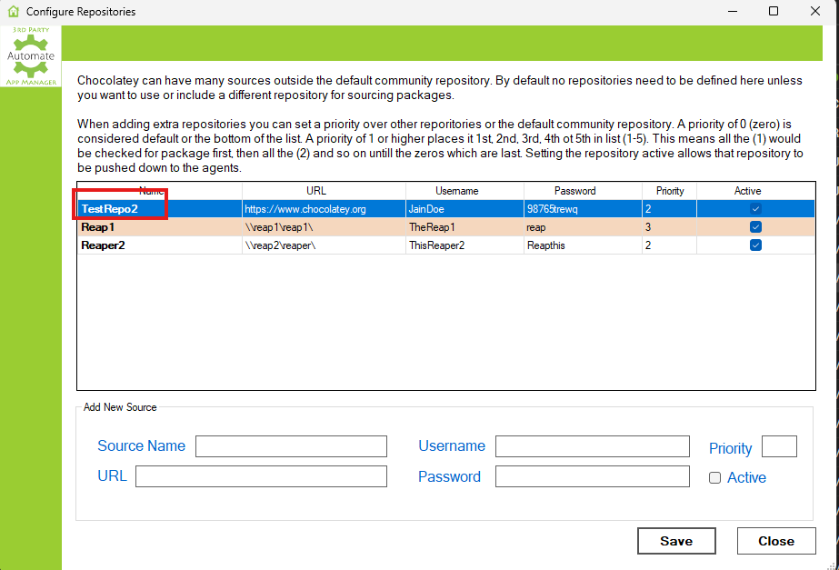

Next add a new source:
Screenshot 2025-03-11 143409.png (43.83 KiB) Viewed 11669 times

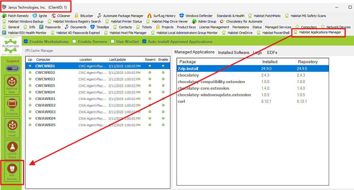

Goto Client's console - Habitat Application Manager tab, Select the assign Sources button:
Screenshot 2025-03-11 144248.png (109.7 KiB) Viewed 11669 times

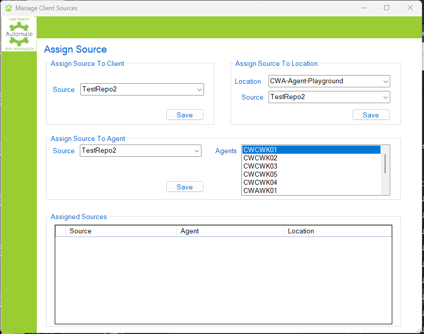

Then assign the source to Client, Location or agent.

If you check EDFs for agent then "Use Sources" will now be checked and Sources Enabled and Use Standard deployment may or may not be checked based on where in the progress the agent is. Sources are set based on group membership.
