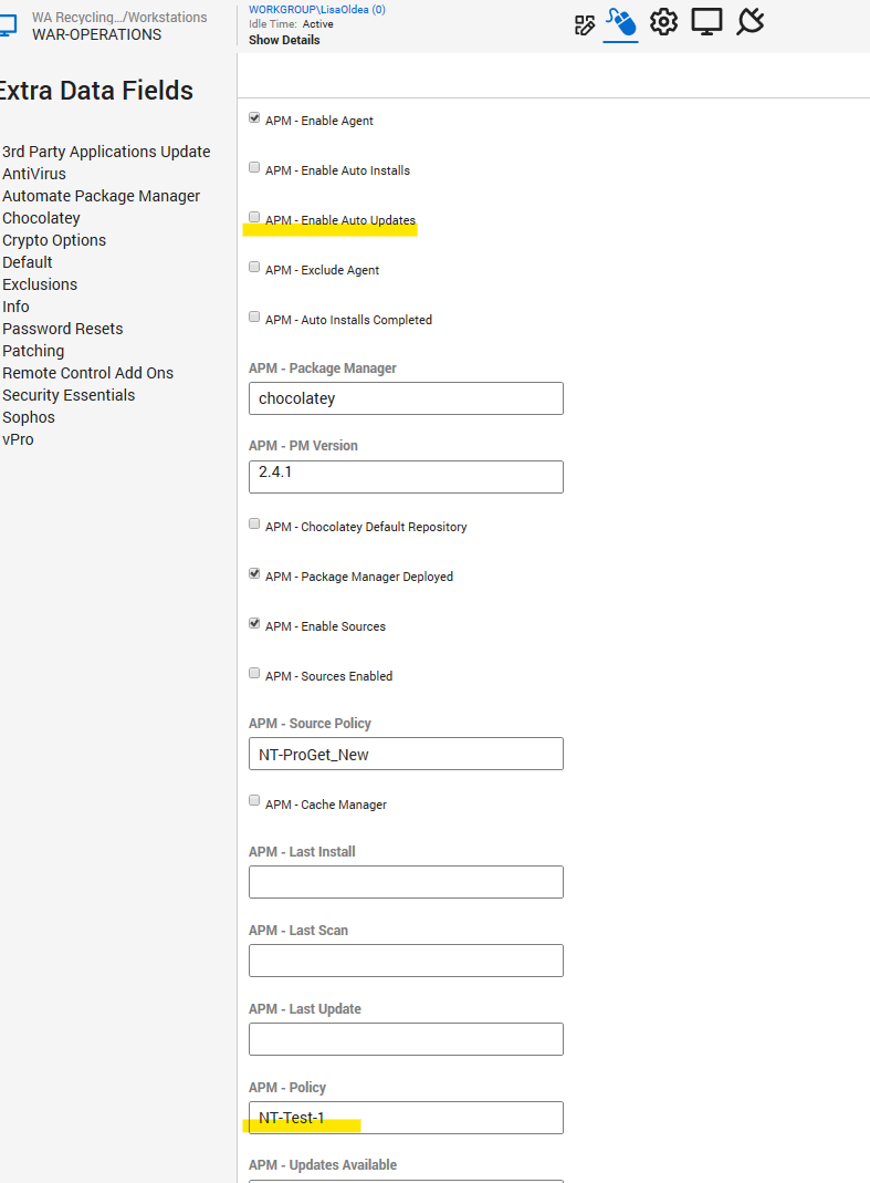

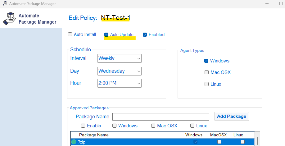

I just created a new policy with the Auto Update option enabled and assigned to a location. Noticed that the agents haven't checked the EDF "APM-Enable Auto Updates" box after the policy being applied.
Screenshot 2024-12-11 125130.png (89.09 KiB) Viewed 18279 times
Screenshot 2024-12-11 125035.png (34.63 KiB) Viewed 18279 times

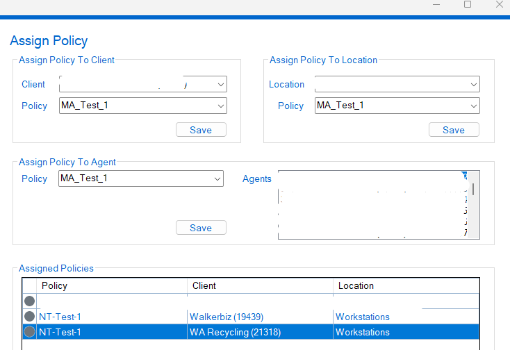

How di you apply this policy? By Client , By location or by agent? I need to know the control used to apply policy so I look in the right place fo a issue.

Re: EDF APM-Enable Auto Updates - not being checked when the APM policy is applied.
Posted: Wed Dec 11, 2024 11:45 pm
by leosq
I have applied the policy by location.
Screenshot 2024-12-12 074320.png (23.29 KiB) Viewed 18234 times
Posted: Thu Dec 12, 2024 2:20 pm
We just posted build 1.0.0.24, we made a slight change to the enabler function for location and agent. The client enabler function had seemed to already had this change added to it. We suppect that this may be cauing your issue. We have tested in our limited environment but will look to hear back from you is this build has resolved your issue.
