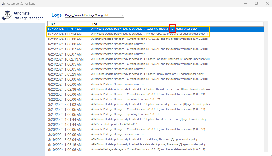

can you screen shot your applied policy for this agent? Next have a look at the server logs and see if you see agents counted during policy execution.
Screenshot 2024-08-26 164523.png (87.92 KiB) Viewed 20588 times
Next , based on time stamp above logs, have a look at the agent command and script logs during time frame to see if there were any error logs generated on agent.
**Note ** Agents must be online during update operations and is skipped if offline.

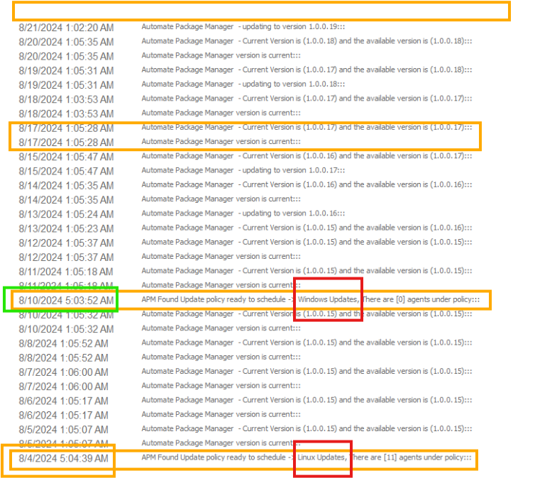

Going over your logs and looking at your policiy list, I see an attempt to to run a Windows Update policy on the same cycle as what the Linux updates was previously scheduled but I do not see that policy in list currently. I assume that was added then deleted prior to this post?
The schedule may be missing its scheduling window due to the speed of the ISYNC process in Automate. Our function test is doing a (> 6), when it really should be (>= 6) which should make no since to you, but in the ISync dev world, is worth a whole minute before the next ISync cycle.
I will make this adjustment and we can see if that resolves your issues. Give me a chance to push out an update.

Please make sure that at least 1 Linux EDFs show that the Linux Update policy is applied to them.

verified
and looks like your change fixed it as seeing everyhting that has the policy applied patched on 9/1 which is the correect date
Re: Policy not patching systems
Posted: Wed Sep 04, 2024 1:16 pm
My change hasn't been released yet... So that may be a valid issue still for you. If your Automate system is operating in the zone then this shouldn't be an issue.
Thats good, Our release will be out in the next few days and will happen automaticlly for you.
Problem solved.
