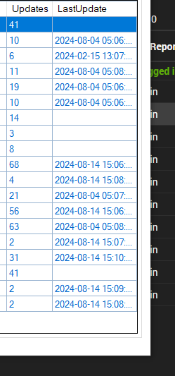

seem to have an issue, we are trying to patch our ubuntu 22.4 servers.
this was working prevousily we have a policy to patch them every sunday at 5 am.
they have listed patches available but have not patched in two weeks except when i manually pushed patches to soem of then on 8/14.
attached an image showing the currect patch dastes
Policy not patching systems
- 2024-08-23_11-13-41.png (14.16 KiB) Viewed 20735 times

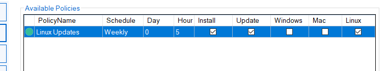

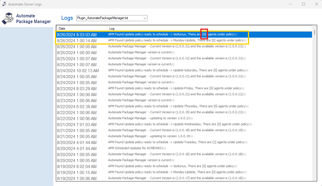

can you screen shot your applied policy for this agent? Next have a look at the server logs and see if you see agents counted during policy execution.
Next , based on time stamp above logs, have a look at the agent command and script logs during time frame to see if there were any error logs generated on agent.
**Note ** Agents must be online during update operations and is skipped if offline.
Re: Policy not patching systems
applied policy

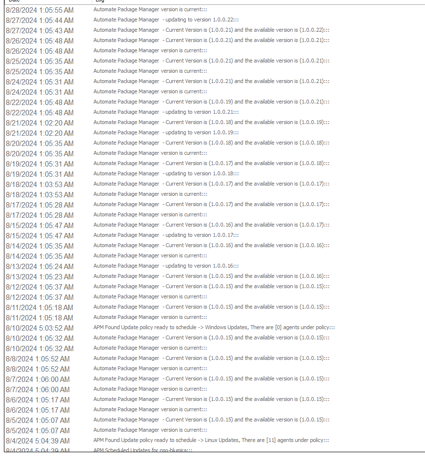

attached screenshot not seeing anything in l.ogs other then 14 when i manually pushed updates.

- log.png (120.85 KiB) Viewed 20550 times
- policy.png (7.09 KiB) Viewed 20550 times

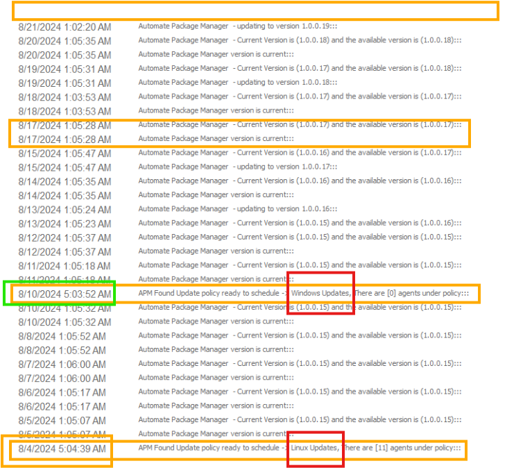

Going over your logs and looking at your policiy list, I see an attempt to to run a Windows Update policy on the same cycle as what the Linux updates was previously scheduled but I do not see that policy in list currently. I assume that was added then deleted prior to this post?
The schedule may be missing its scheduling window due to the speed of the ISYNC process in Automate. Our function test is doing a (> 6), when it really should be (>= 6) which should make no since to you, but in the ISync dev world, is worth a whole minute before the next ISync cycle.
I will make this adjustment and we can see if that resolves your issues. Give me a chance to push out an update.

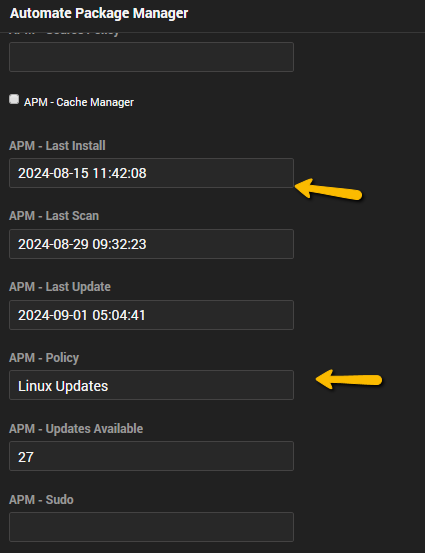

Please make sure that at least 1 Linux EDFs show that the Linux Update policy is applied to them.
verified
and looks like your change fixed it as seeing everyhting that has the policy applied patched on 9/1 which is the correect date
- 2024-09-03_14-40-54.png (31.53 KiB) Viewed 20430 times
