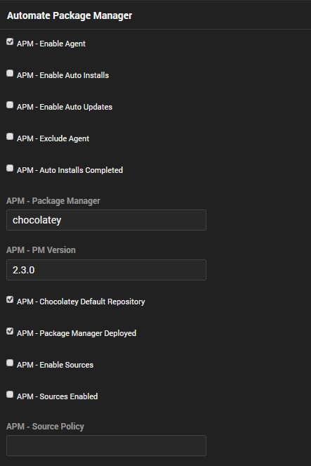

The latest update improved things, absolutely and I have moved forward only to encounter the Auto Update and Auto Install flags set in the policy is not impacting the actual agent. The Policy shows being assigned to the agent in the EDF. Source policy also shows assigned in the EDF but the checkboxes/text for Choco Default Repo is still checked.

The same thing takes place for Sources. Once you have created a source and applied it to an agent via the plugin interface, the agents EDF "Enable Sources" is now set to true along with the Source policy name. This causes agent to join the Deploy Sources sub group where the script "Deploy Sources" get run against agent. If successful, the script will set the EDF "Sources Enabled" which will cause the agent to leave the deploy sources sub group.

I have said Deploy Source Policy group, but no scripts are assigned to the group. Also, I do not see a script called "Deploy Sources" at all.

Ah,
Your missing the sources script, I bet that will cause confussion. That cause the issues your seeing where checkboxes are not set for sources. This solves the reason you were having SQL errors with script ID, The script was missing so there was no ID to query.
Build 1.0.0.18 should resolve that issue.
https://delivery.shopifyapps.com/-/3152 ... 5738baef53
Update your plugin, restart the DBagent and allow a few minutes for the DBagent to complete it's tasks. Verify that this script now exists.
Also make sure that script is assigned in the group. Seeing that script was missing I bet that the group could not find "scriptID" which was the SQL error you were getting before. The group is already created, so the DBagent will not modify it now.
After plugin update and DBagent restart,
Open the Groups in Automate, Find the Deploy Source Policy group and edit it. Under the Scheduled Scripts section, verify that the following script is listed and scheduled for group. I suppect it will not be as it was created before script exisited. Use the Script selection box to locate the APM Deploy Agent Sources script and schedule it to run "Daily" every 4 hours. This will correct your issues and will allow sources to be set as expected. During source configurations the Chocolatey Default Repository will be unchecked by the source management script.
