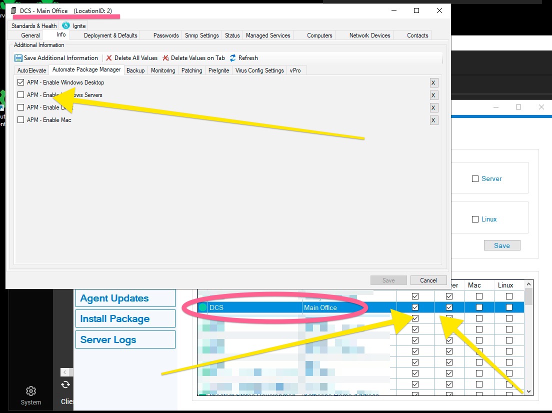

Gone through setup and forcing singular package installs is working but scans and policies are not. Doing some checking and I may have found something related. The EDF's which ultimately are what triggers stuff I believe, are not reflecting what the APM GUI shows.
When enabling agents, I have clicked the Desktop/Laptop and Server checkboxes under the Windows section. Then picking a client and hit save. It then appears in the box down below as "enabled" and has Desktop AND Server checkboxes in them. However, looking at the EDF's for those client locations and the EDF for workstation is checked but server is NOT checked. This behavior is seen on ALL clients/sites.

Re: Enable Agents Checkboxes not applying to EDF's
Looks like a bug, let me go look and see if I can recreate that issue, I'll get back to you once completed.
Yeap, A typo. I reference the EDF by name and I forgot to make servers plural when setting EDFs.
I will have a fix out today for this, Will also look at the edit policy issue while im here...
It took a little while but we have Build 1.0.0.16 released and ready. You now have a right click menu on the policy list that provides a set of menu items (Edit and Delete). Edit wil load a form with content so you can make changes to policy. I fixed the issue with Windows Server check box not checking when settings a policy.

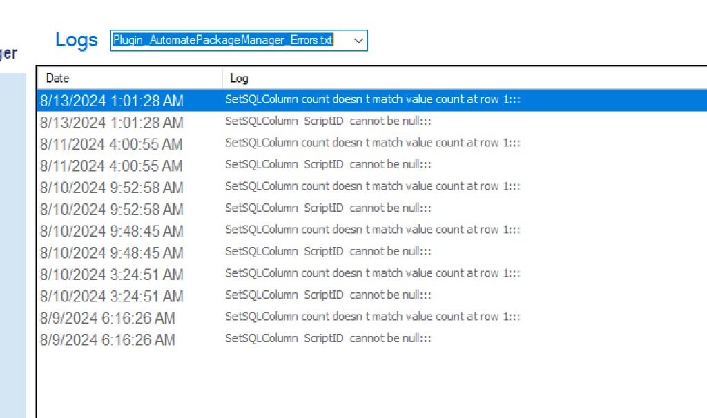

Finally, dunno if this is relevant but I am seeing this in the logs:
Zight 2024-08-14 at 1.24.44 AM.jpg (131.32 KiB) Viewed 50031 times
Oh thats no good, Sure enough build 1.0.0.14 shows this change showing up in code. I have corrected this in build 1.0.0.17 now available for download. APM plugin should auto update later tonight.

As for the SQL error,
Please update your plugin to latest build, remove the error file, restart the dbagent.
Afterwards allow a minute or two then have a look to see if new error file exist. If so post the error here.
If it does not show up right away, check back in 24 hours to see if error comes from backend automation.
Post that here if so.
This will help me track down your issue. I am not seeing any error logs on our test system currently.

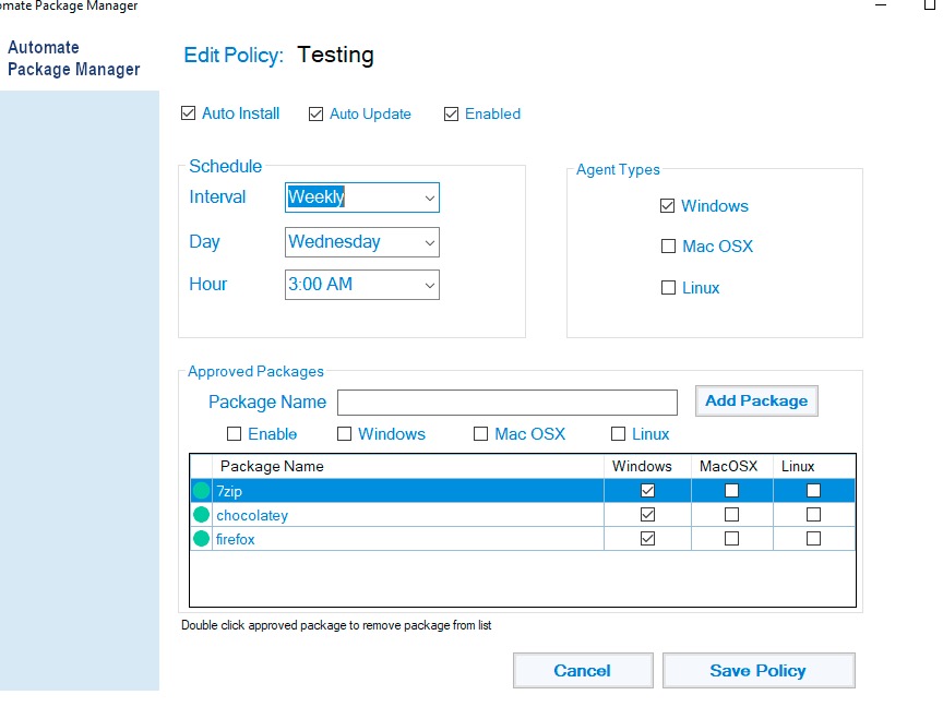

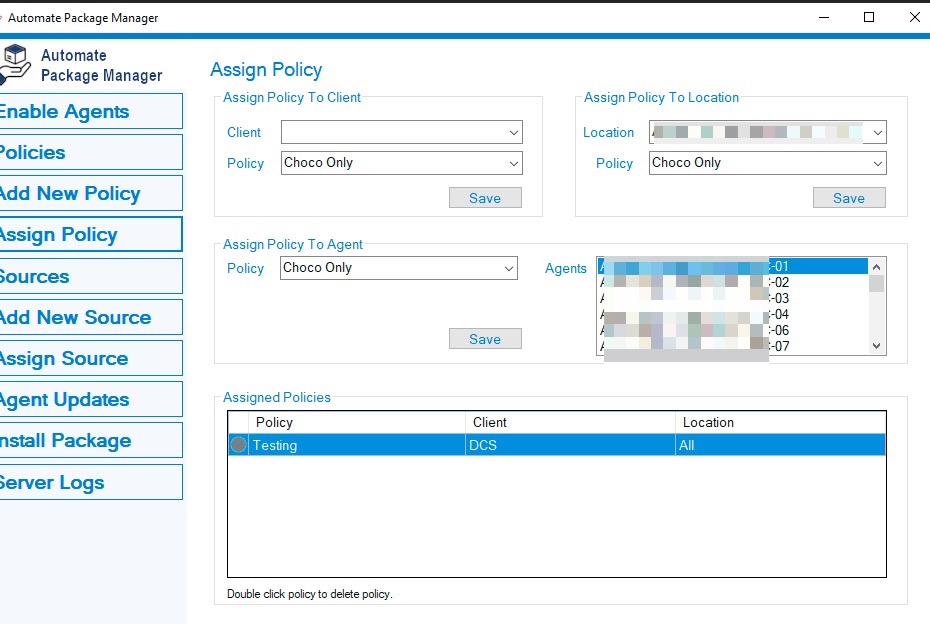

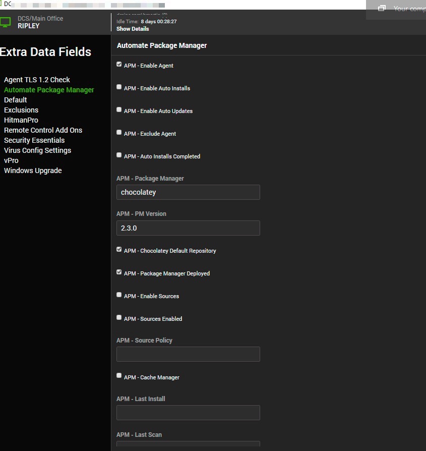

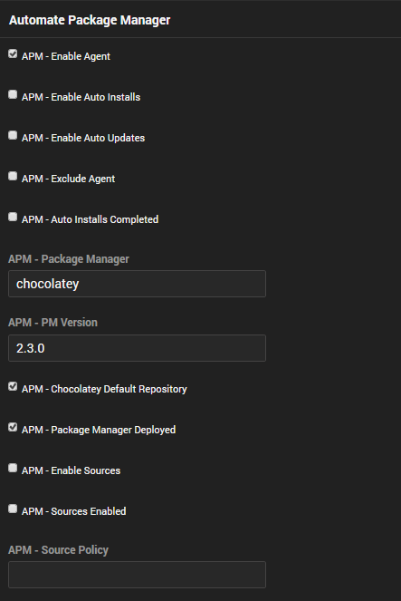

The latest update improved things, absolutely and I have moved forward only to encounter the Auto Update and Auto Install flags set in the policy is not impacting the actual agent. The Policy shows being assigned to the agent in the EDF. Source policy also shows assigned in the EDF but the checkboxes/text for Choco Default Repo is still checked.

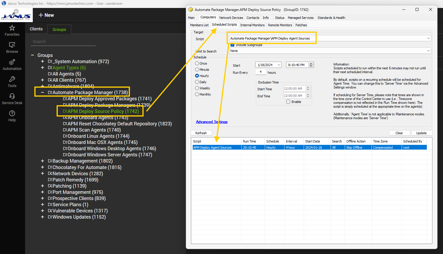

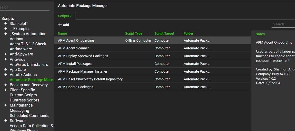

I have said Deploy Source Policy group, but no scripts are assigned to the group. Also, I do not see a script called "Deploy Sources" at all.
Policy Screenshot I am testing with is below. Only one policy is applied to the Client-ALL Locations.

Ah,
Your missing the sources script, I bet that will cause confussion. That cause the issues your seeing where checkboxes are not set for sources. This solves the reason you were having SQL errors with script ID, The script was missing so there was no ID to query.
Build 1.0.0.18 should resolve that issue.
https://delivery.shopifyapps.com/-/3152 ... 5738baef53
Update your plugin, restart the DBagent and allow a few minutes for the DBagent to complete it's tasks. Verify that this script now exists.
Also make sure that script is assigned in the group. Seeing that script was missing I bet that the group could not find "scriptID" which was the SQL error you were getting before. The group is already created, so the DBagent will not modify it now.
After plugin update and DBagent restart,
Open the Groups in Automate, Find the Deploy Source Policy group and edit it. Under the Scheduled Scripts section, verify that the following script is listed and scheduled for group. I suppect it will not be as it was created before script exisited. Use the Script selection box to locate the APM Deploy Agent Sources script and schedule it to run "Daily" every 4 hours. This will correct your issues and will allow sources to be set as expected. During source configurations the Chocolatey Default Repository will be unchecked by the source management script.
Screenshot 2024-08-19 114339.png (205 KiB) Viewed 49709 times
