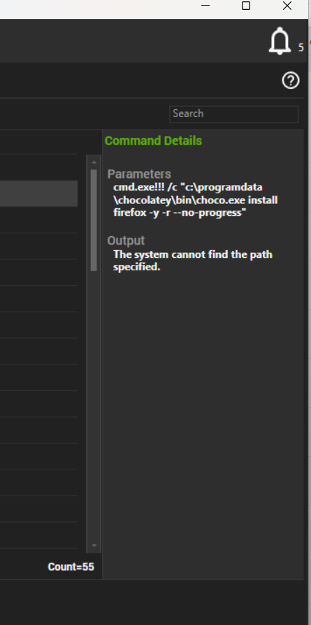

Receiving output - system cannot find the specified path.
Posted: Fri Jun 21, 2024 9:28 pm
by Lantern5611
When running the install via policy and schedule, or a direct install package this is the output received in the command logs in Automate. On the device itself, the directory doesn't exist, but chocolatey is installed; running
'choco install firefox'
starts the installation and finishes successfully. Do you know why this would happen?
Re: Receiving output - system cannot find the specified path.
Posted: Mon Jun 24, 2024 3:45 pm
Chocolatey is not at that location. This is the default location Chocolatey should exist if the plugin deployed Chocolatey.
Can you verify if the plugin has completed the deployment process yet? The agents EDFs for Chocolatey would show chocolatey deployed checked.
Posted: Mon Jun 24, 2024 3:46 pm
If it is checked and that location does not exist, uncheck the box and the automation will reattempt an install of Chocolatey to that directory.
Posted: Thu Jun 27, 2024 6:35 pm
by Lantern5611
The box was initially unchecked. I checked it, and then unchecked it. No changes yet.
Posted: Thu Jun 27, 2024 6:47 pm
by Lantern5611
Upon inspecting other devices, it looks like chocolatey has not deployed to the location selected after enabling the agents on that location.
Posted: Fri Jun 28, 2024 1:13 pm
Sounds like there is a block in place. I answered you PM with what I believe are your next steps. We can converse there on solution.
Posted: Fri Jun 28, 2024 2:04 pm
Here is a word doc on the mods needed to fix your issues.
C4A-ChangeChocolateySources.docx
(702.64 KiB) Downloaded 490 times
