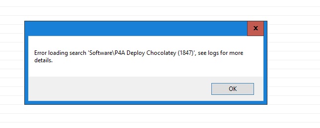

The searches are in the correct location aswell, but if I go directly to the search and try to open it, automate throws out an error like it is unable to read the search to give me the details.Almost like the search was created on plugin install,but no contents are in them or something
I was thinking of just removing those searches that are "corrupt" and recreate them manually and attach to the groups,but I wont have them exactly the same way as they are supposed to be,which is why I am hesitant to do so

I removed the searches from the linked groups then deleted the searches that were unreadable
They have been recreated,but still not able to open them

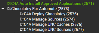

I just noticed that the group "C4A Auto Ins5tall Approved Applications" is not created as a subgroup under Chocolatey for Automate,its not a big issue really,but just want to notify you about that
Thank you for finding the problem and resolving it
