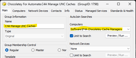

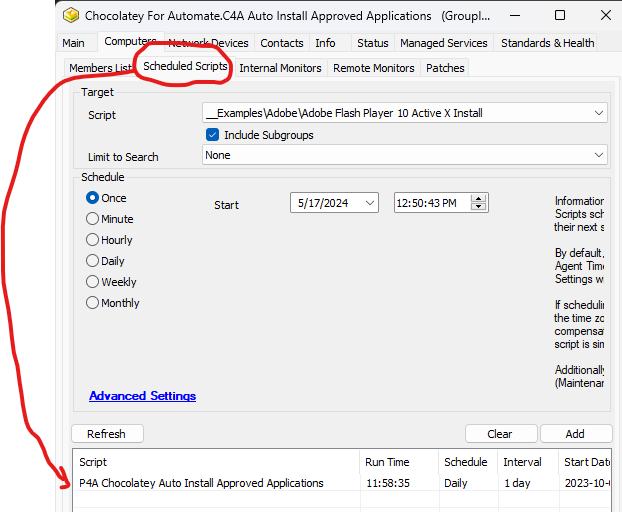

Re: C4A groups no populating

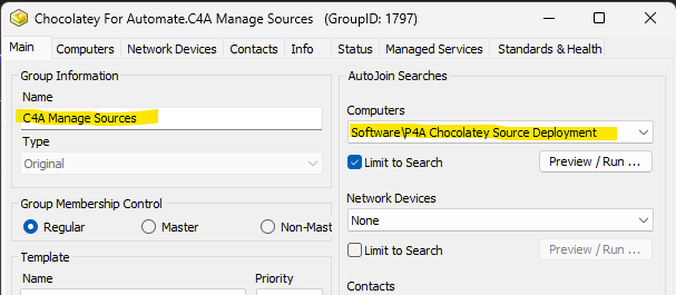

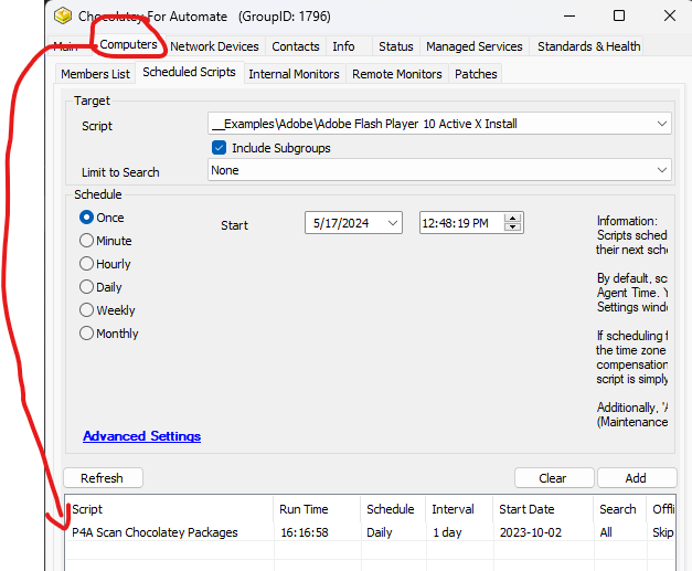

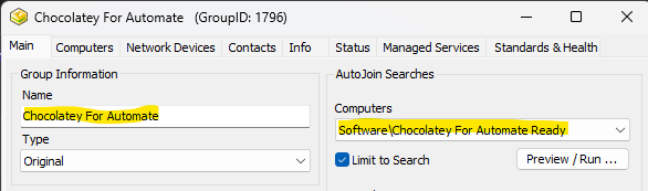

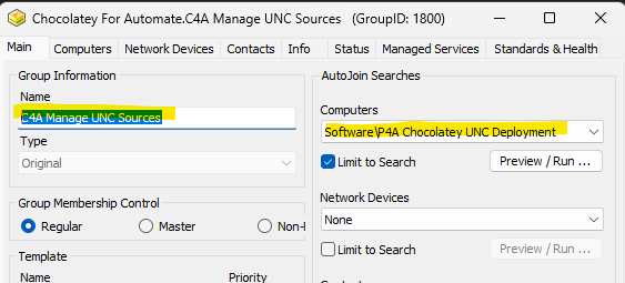

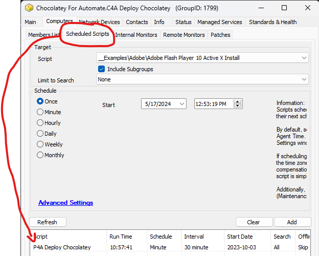

Make sure you on lates version 3.6.0.11,
Next, it sounds like your install of Chocolatey failed to couple the groups with their search scripts and maybe even the scheduled script tasks.
This is a problem and will prevent services from working and is not by design. Automate likes tossing us curve balls all the time so it maybe a one off fluke or a sign of some other issue we have not seen yet. If it happens again then let us know so we can start tracking the issue.
Anyhow, You will need to fix the associations between each group and its search and scheduled script functions. Each Group has a particular search and script it executes. These must be there for operations to work as expected. It they are missing are easily fixed by the following.

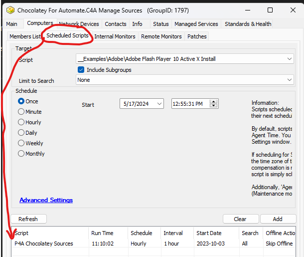

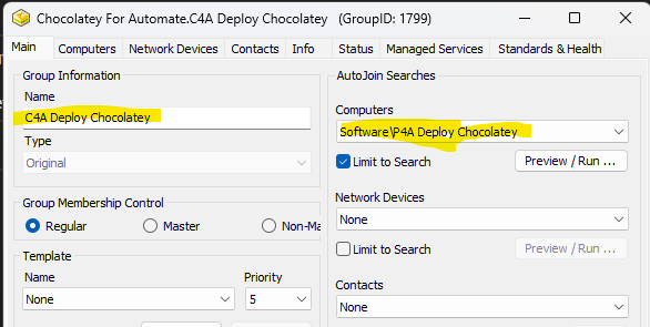

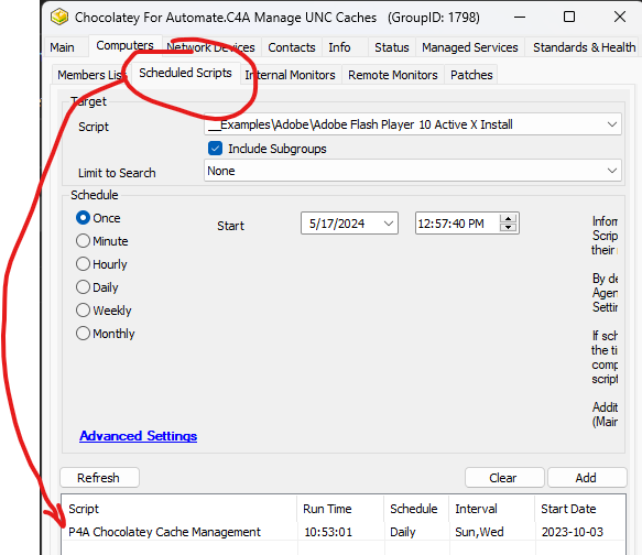

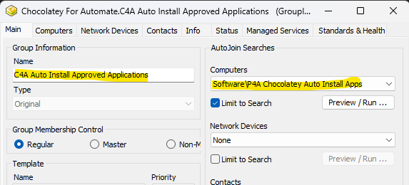

Open each group and check the search to match the search provided in images below for each group. Then select the computers tab in the same group and then the Scheduled scripts sub tab. There should be a single scheduled script in the scheduled scripts list. If not use the tool above the list to locate this script by name and then schedule it as you see fit. You can choose our default settings (see image) or choose a different schedule based on the needs of your environment.
Save each group after edits and you should be good to go.

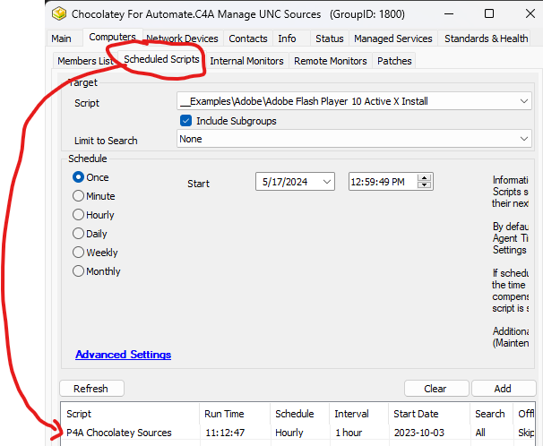

The Main Chocolate For Automate Group
Screenshot 2024-05-17 124707.png (16.13 KiB) Viewed 59745 times
Screenshot 2024-05-17 124841.png (44.02 KiB) Viewed 59745 times
C4A Auto Install Approved Applications
Screenshot 2024-05-17 125021.png (26.21 KiB) Viewed 59745 times
Screenshot 2024-05-17 125056.png (43.67 KiB) Viewed 59745 times
C4A Deploy Chocolatey
Screenshot 2024-05-17 125258.png (27.58 KiB) Viewed 59745 times
Screenshot 2024-05-17 125327.png (44.84 KiB) Viewed 59745 times
C4A Manage Sources
Screenshot 2024-05-17 125457.png (24.43 KiB) Viewed 59745 times
Screenshot 2024-05-17 125538.png (44.5 KiB) Viewed 59745 times
C4A Manage UNC Caches
Screenshot 2024-05-17 125702.png (23.68 KiB) Viewed 59745 times
Screenshot 2024-05-17 125753.png (43.32 KiB) Viewed 59745 times
C4A Manage UNC Sources
Screenshot 2024-05-17 125920.png (23.61 KiB) Viewed 59745 times
Screenshot 2024-05-17 125955.png (43.26 KiB) Viewed 59745 times
Also let us know if any of the searches or scripts are not where images show they should be in the folder structure for searches and scripts.

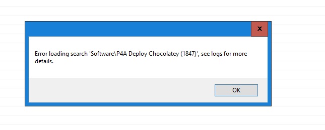

The searches are in the correct location aswell, but if I go directly to the search and try to open it, automate throws out an error like it is unable to read the search to give me the details.Almost like the search was created on plugin install,but no contents are in them or something

I removed the searches from the linked groups then deleted the searches that were unreadable
They have been recreated,but still not able to open them

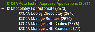

I just noticed that the group "C4A Auto Ins5tall Approved Applications" is not created as a subgroup under Chocolatey for Automate,its not a big issue really,but just want to notify you about that
Thank you for finding the problem and resolving it
