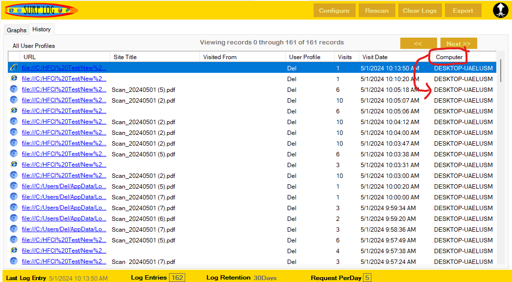

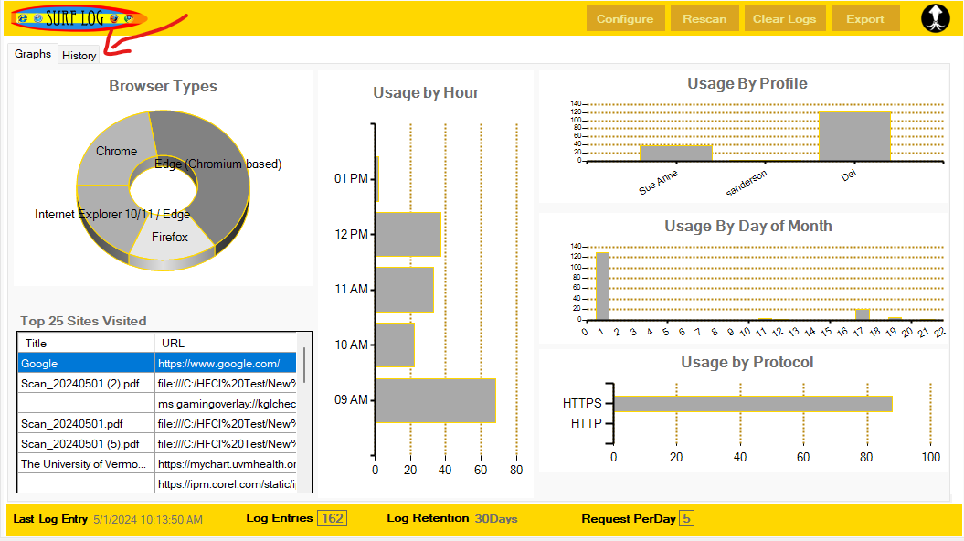

Here is a small client with some data visible in the Client Console, select the History tab.
Screenshot 2024-05-06 084652.png (80.51 KiB) Viewed 9679 times
Now in the logs it reports the agent that the logs were captured from.
Screenshot 2024-05-06 084728.png (110.93 KiB) Viewed 9679 times

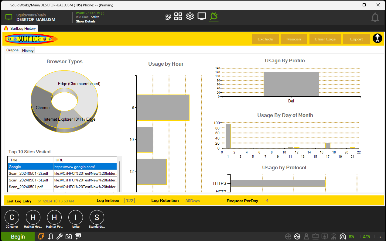

Lets open the computer console for this agent and view it's Surflog data individually.
Screenshot 2024-05-06 084849.png (105.88 KiB) Viewed 9679 times
If data is in client console then its the same data in the agent console, just filtered down to only that one agent.
