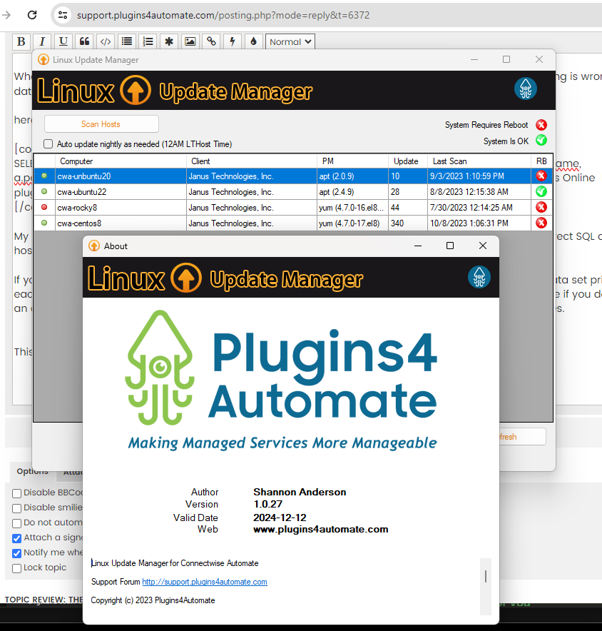

When this window loads, it calls 1 function that makes a SQL query and fills the table with data. If something is wrong with the data, something missing or SQL failing all together, would cause the error you see.
here is that SQL Query,
SELECT a.computerid, a.computer_name, a.clientid, a.updates, a.last_scan, a.reboot_needed,  a.client_name, a.package_manager, a.pm_version, IF(c.LastContact > date_add(now(),interval -6 minute),'Yes','No') As Online  FROM plugin_p4a_lum_agents a LEFT JOIN computers c ON c.computerid = a.computerid
My next question is, are you using a on prem or hosted Automate environment? Basically do you have direct SQL access to host to execute the above SQL query to see what is returned?
If your hosted, then you will need to create a LT script that executes that query. Then loops through the data set printing out each row. If script can print out rows and data looks good, post the return here for us to review. Otherwise if you do receive an error then it may answer your issue directly or send us the errors and we can help determine the issues.
This is not normal for plugin. Here is our running version of 1.0.27 of the LUM plugin.
Do not mind the scan dates, I have this plugin disabled as not to interfere with our current development of Automate Package Manager plugin which also manages the install and update of Linux agents along with Mac and Windows.

Below is the output from the SQL Query
Should we move to Automate Package Manager instead ?
1 queries executed, 0 success, 1 errors, 0 warnings
Query: SELECT a.computerid, a.computer_name, a.clientid, a.updates, a.last_scan, a.reboot_needed, a.client_name, a.package_manager, a.p...
Error Code: 1146
Table 'labtech.plugin_p4a_lum_agents' doesn't exist
Execution Time : 0 sec
Transfer Time : 0 sec
Total Time : 0.001 sec
Re: the object reference has not been set to an instance of an object
Posted: Thu Mar 21, 2024 9:33 pm
Ok there's the problem, first thing is do a restart of the dbagent on automate host.
The dbagent service is responsible for creating that table. Once confirmed, relaunch the control center and reopen plug-in.
If it still fails report back.
As for APM, didn't mean to bait and switch you. LUM is a nice Linux plugin, but APM has really taken the best of all out early plugins like C4A, LUM, and our Habitat Homebrew sub plugin and combines them with a whole new approach to managing software in Automate.
If you want what we are working on now, APM is it!
