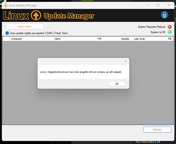

Just updated to 1.0.27 and get error and no Linux servers are listed and get an error.
"the object reference has not been set to an instance of an object"
Sorry for the Swedish pic.
Any idees ?
Running latest version on Automate also.

When this window loads, it calls 1 function that makes a SQL query and fills the table with data. If something is wrong with the data, something missing or SQL failing all together, would cause the error you see.
here is that SQL Query,
My next question is, are you using a on prem or hosted Automate environment? Basically do you have direct SQL access to host to execute the above SQL query to see what is returned?
If your hosted, then you will need to create a LT script that executes that query. Then loops through the data set printing out each row. If script can print out rows and data looks good, post the return here for us to review. Otherwise if you do receive an error then it may answer your issue directly or send us the errors and we can help determine the issues.

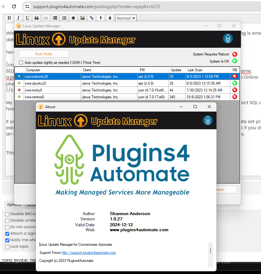

This is not normal for plugin. Here is our running version of 1.0.27 of the LUM plugin.
Do not mind the scan dates, I have this plugin disabled as not to interfere with our current development of Automate Package Manager plugin which also manages the install and update of Linux agents along with Mac and Windows.
