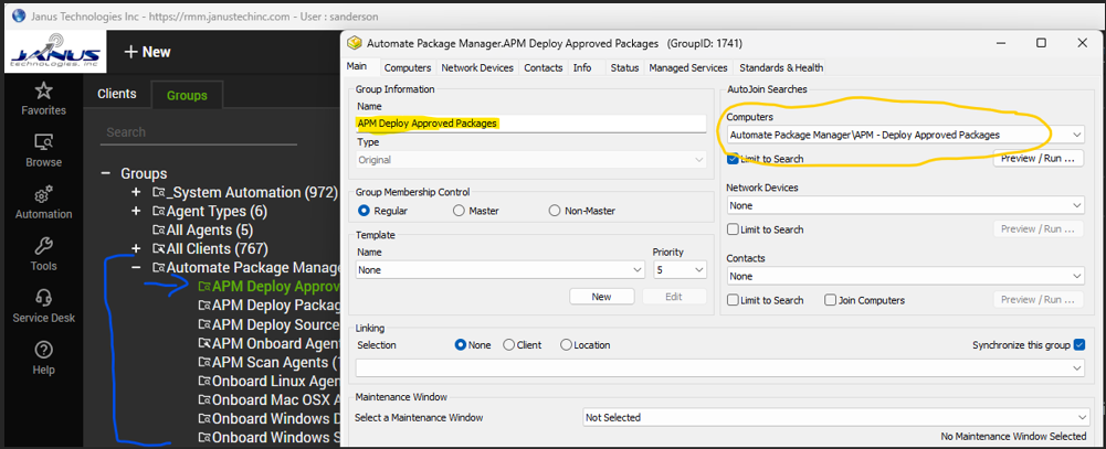

All other functions are organized and controlled by groups. Within your group list, you will find Automate Package Manager, which contains several subgroups, each representing a specific function. For instance, in the context of "Auto Installing Approved Packages," the APM Deploy Approved Packages group will oversee the installation of approved packages.

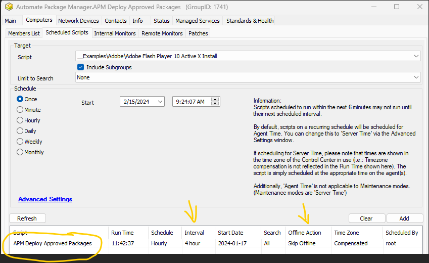

Within the Groups - Computers - Scheduled Scripts Tab, you can locate the schedule and script name that will be executed when an agent joins the group. This script runs every 4 hours on any agent within the group. Upon completion of the script on an agent, the EDF Auto Installs Completed should be marked with a check in the box. This action disqualifies the agent from the Deploy Approved Packages group, leading to its disassociation from the group.
The intention is for this group to remain mostly empty. Agents are expected to briefly join the group for approximately 4 hours, executing the script once, and then leaving the group before the next scheduled script. You have the flexibility to adjust the schedule to your preferences. However, it's important to note that setting the schedule too fast (under 15 minutes per run) may result in agents executing the script twice before departing from the group.

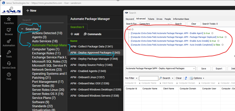

Each group is configured with a search setup designed to automatically include any agent that meets specific criteria based on the set EDFs. For the Auto Installs group, agents must satisfy the following conditions: they must be enabled, the Package Manager should indicate as deployed, Auto Installs must be enabled, and Auto Installs Completed should be disabled.
A noteworthy point to consider is that if you wish to have an agent undergo the auto installs process again—perhaps due to adding new packages to the list or if the agent encountered failures during the previous auto install—you can achieve this by unchecking the Auto Installs Completed EDF and saving the changes. This action should prompt the agent to rejoin the Deploy Approved Packages group, allowing for a fresh attempt at installing the packages.
Review the agent EDFs to determine the current status of the agent within the stack of functions. For every function that needs enabling in the EDFs, there is a corresponding EDF indicating that the automated group functions have completed their tasks. To initiate a retry for any specific function, simply uncheck the acknowledgement checkbox associated with that particular function. This action will prompt the system to reattempt the function, ensuring that the agent goes through the necessary processes again.

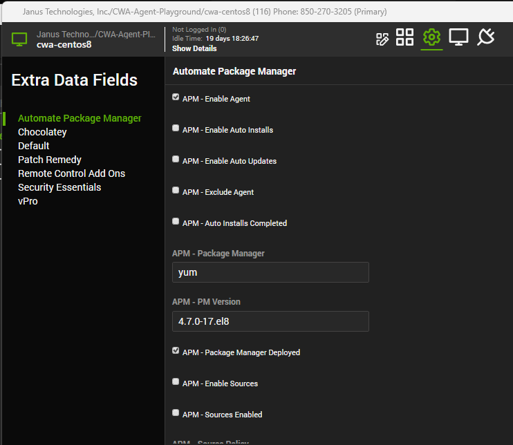

I have attached additonal images of the scan there are two errors at the end of the scan, and also a pic of the EDF that are checked for that system.

As for the errors, I'll look into that but from the return shown in image, all data was returned as expected for a "Scan" and you are seeing packages that are installed on agent and the versions they are.
It also shows via your EDFs that everything is enabled (Auto installs and Auto Updates) and that both the daily scans are completing and it looks like the Installs were pushed out.
The next thing to monitor is do we get a Update Date sometime after our scheduled updates settings.
