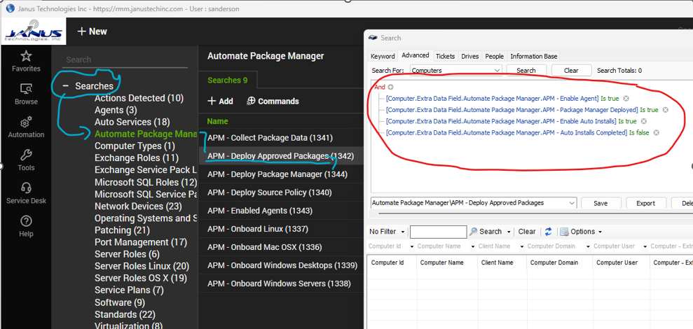

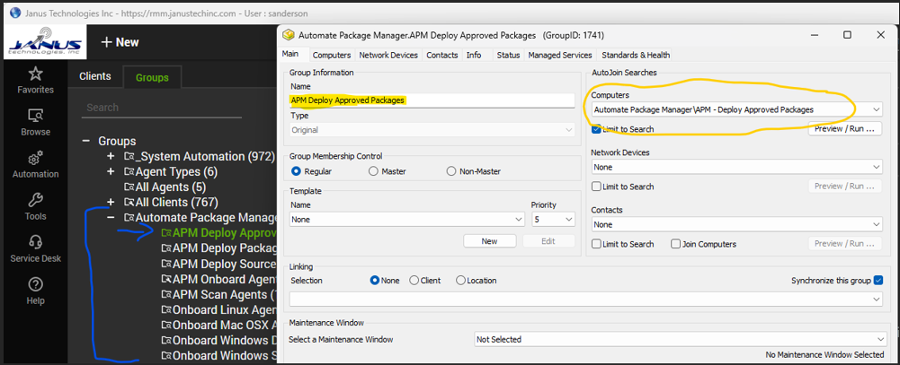

All other functions are organized and controlled by groups. Within your group list, you will find Automate Package Manager, which contains several subgroups, each representing a specific function. For instance, in the context of "Auto Installing Approved Packages," the APM Deploy Approved Packages group will oversee the installation of approved packages.

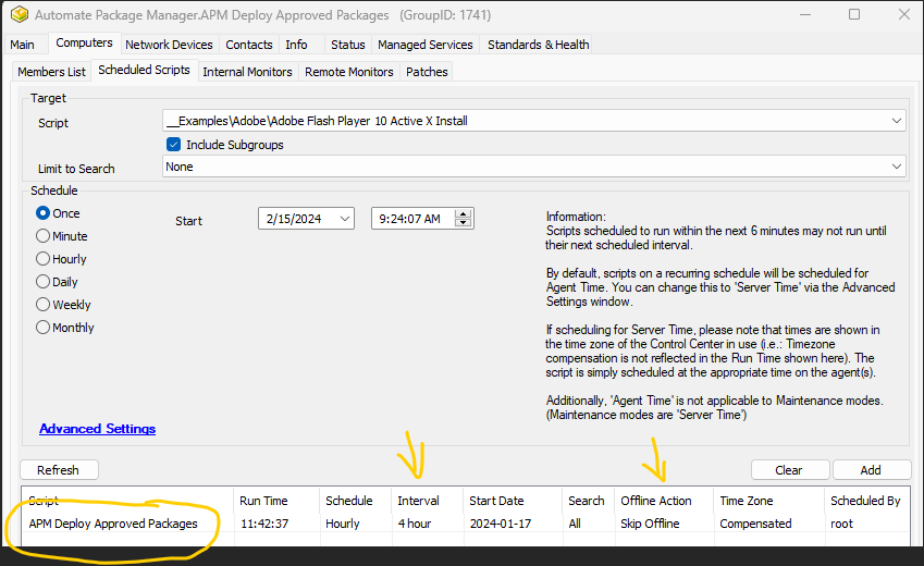

Within the Groups - Computers - Scheduled Scripts Tab, you can locate the schedule and script name that will be executed when an agent joins the group. This script runs every 4 hours on any agent within the group. Upon completion of the script on an agent, the EDF Auto Installs Completed should be marked with a check in the box. This action disqualifies the agent from the Deploy Approved Packages group, leading to its disassociation from the group.
The intention is for this group to remain mostly empty. Agents are expected to briefly join the group for approximately 4 hours, executing the script once, and then leaving the group before the next scheduled script. You have the flexibility to adjust the schedule to your preferences. However, it's important to note that setting the schedule too fast (under 15 minutes per run) may result in agents executing the script twice before departing from the group.

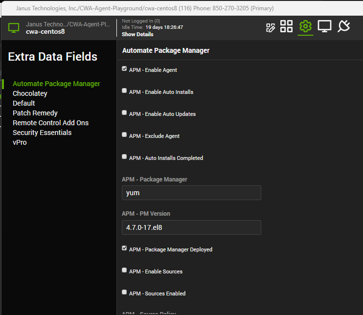

Each group is configured with a search setup designed to automatically include any agent that meets specific criteria based on the set EDFs. For the Auto Installs group, agents must satisfy the following conditions: they must be enabled, the Package Manager should indicate as deployed, Auto Installs must be enabled, and Auto Installs Completed should be disabled.
A noteworthy point to consider is that if you wish to have an agent undergo the auto installs process again—perhaps due to adding new packages to the list or if the agent encountered failures during the previous auto install—you can achieve this by unchecking the Auto Installs Completed EDF and saving the changes. This action should prompt the agent to rejoin the Deploy Approved Packages group, allowing for a fresh attempt at installing the packages.
Review the agent EDFs to determine the current status of the agent within the stack of functions. For every function that needs enabling in the EDFs, there is a corresponding EDF indicating that the automated group functions have completed their tasks. To initiate a retry for any specific function, simply uncheck the acknowledgement checkbox associated with that particular function. This action will prompt the system to reattempt the function, ensuring that the agent goes through the necessary processes again.

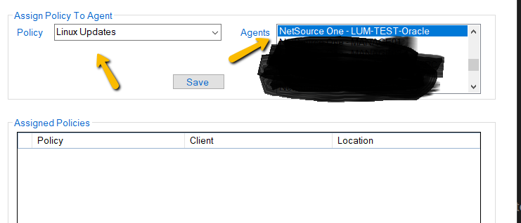

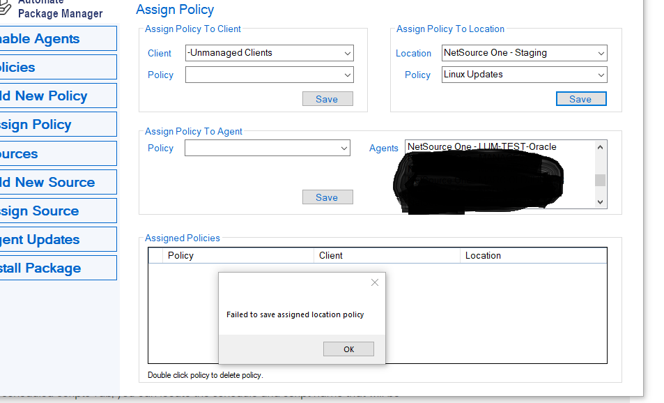

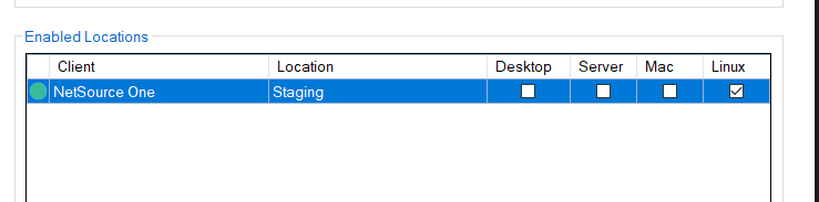

ok the APM Deploy Approved Packages group is empty, I have enabled the Location.

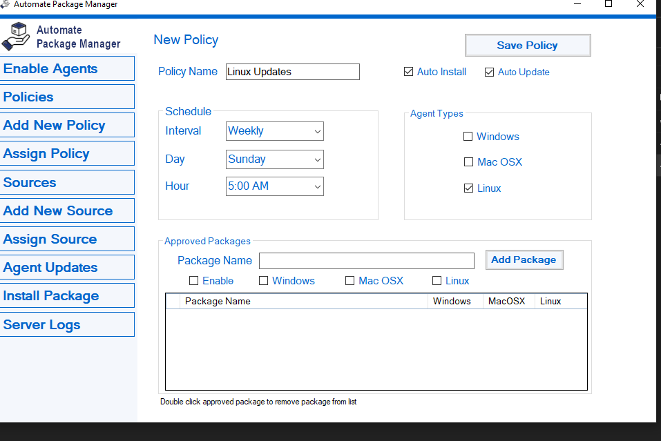

I have also tried to assign a policy to a specific test machine, Lum-Test-Oracle.
when I click save the assigned policy never appears in the list of assigned policies ( see image)
and if I try to apply the policy to a location I get an error message- Failed to save assigned location policy.

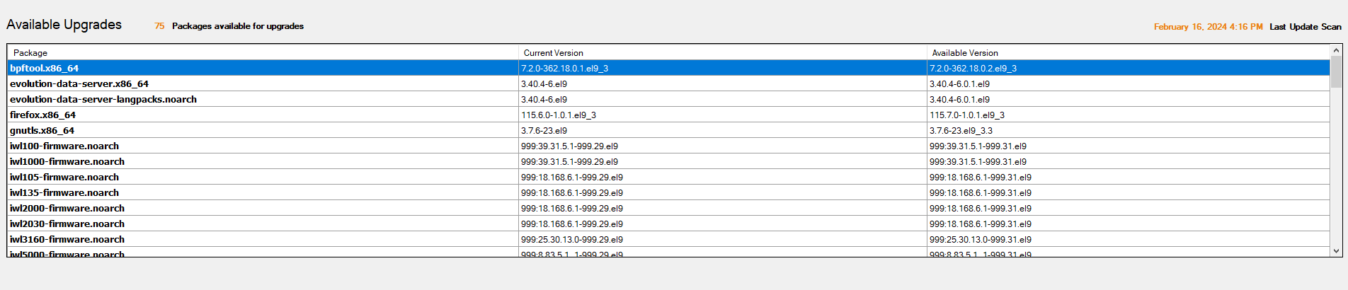

now I have enabled the location and it it does see another linux box in that location and says there a packages available.

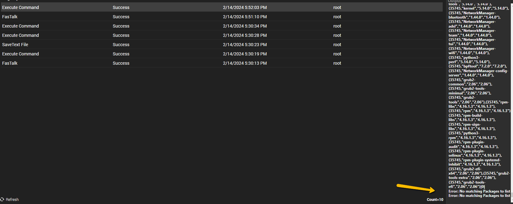

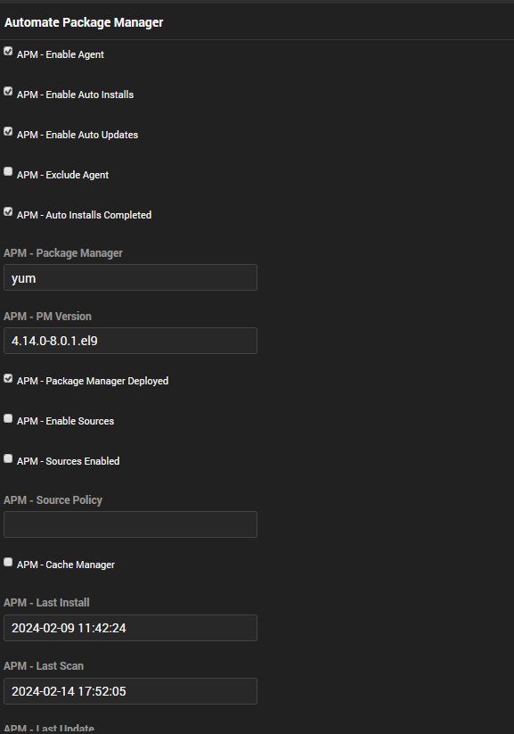

I have attached additonal images of the scan there are two errors at the end of the scan, and also a pic of the EDF that are checked for that system.
Re: Trying to patch a Oracle 9.3 (Linux) system it seems to find packages but they never seem to install

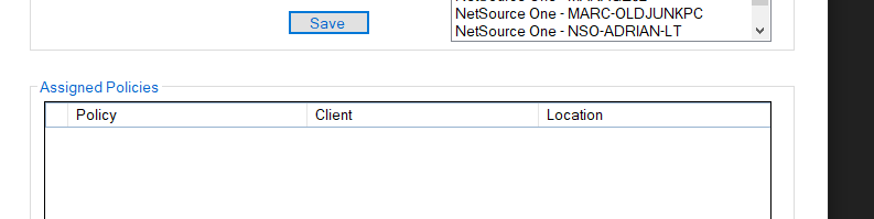

Ok test #1,
Try re adding a location again but, make sure to select the location and the policy in the drop downs, don't just assume that since they are listed they are selected.
I believe this maybe why it failed to save. If so I'll fix that in coming releases Let me know here if that process allowed the save.

As for the errors, I'll look into that but from the return shown in image, all data was returned as expected for a "Scan" and you are seeing packages that are installed on agent and the versions they are.
It also shows via your EDFs that everything is enabled (Auto installs and Auto Updates) and that both the daily scans are completing and it looks like the Installs were pushed out.
The next thing to monitor is do we get a Update Date sometime after our scheduled updates settings.

Also i enabled a location, but as there are 4 other linux boxes under that location, I did want them all patched Just the Lum-Test box,
so when trying to assign the policy to that one system it doesn't seem to save or show its applied
we also had Linux Update manager, I had disabled it but reenabled it and scanned the same machine today. see the images below.
scan with Linux Update Manager.png (37.67 KiB) Viewed 13571 times
Save no policy assigned.png (7.82 KiB) Viewed 13571 times
try to apply policy.png (6.54 KiB) Viewed 13571 times
enabled agent.png (5.88 KiB) Viewed 13571 times

If you want to enable a single agent, then that is easy. Open agent console and manually check to APM - Enable Agent.
If this is all you do then the agent will go through the different functions to validate package manager and version of package manager and will preform a scan daily of agent for installed packages. Once this first scan is fully completed the Update schedule should fire off but not before.
If you do not have Auto install or Auto Update checked then no action other than to read the current packages installed and their versions. Even if you have a policy applied, if the physical boxes are not checked there is no activity. This allows you to override a applied policy where needed or halt any activity on agent after policy setup.

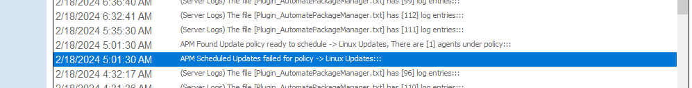

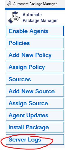

I have now added a the Automate Server Logs Parser into plugin so you can monitor the logs for the Automate Automation.
Screenshot 2024-02-18 112441.png (23.26 KiB) Viewed 13537 times
These logs now show detail information when update actions take place on agents.
Installs, Scans, Package Manager updates all go through Groups. You should see dates in plugin for when these groups are successfully run.
So to verify a update script was pushed see server logs, then follow script logs for any script returns that show an error during updates if you have an issue. Post those script and server logs here.

ok looks like its trying and failing at least per the server logs

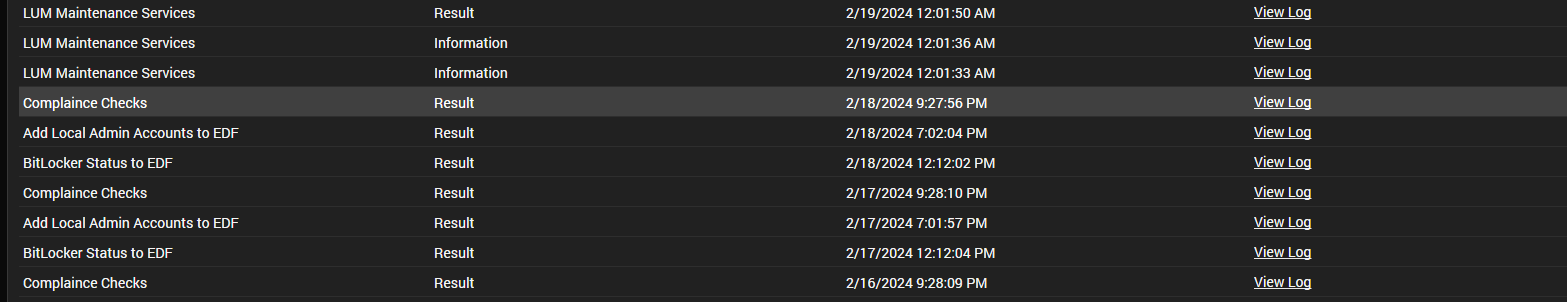

Can you confirm that no scripts were scheduled at the event time on agent?
If so I will look at that process to see what its doing to cause a failure.
strombly
Posts: 17
Joined: Wed Dec 18, 2019 6:46 pm
Post by strombly »
nothing running at that time
