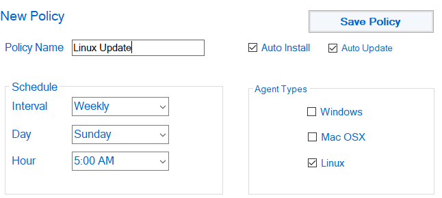

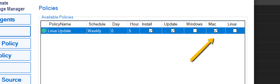

having a weird issue with this build, I just bought it and installed and trying to setup my first policy.
I have deleted it and recreated it 3 times the policy is called Linux Updates the only items checked Linux, but when I save it and go to the policies pane it shows only Mac is checked. Attached two screenshots
Re: Release Build 1.0.0.5
Interesting.
Im out of office today but will look at that. I bet it's setting linux but in data view column is switched, Mac maybe linux and linux Mac.
To test this create a Mac only policy and see if it shows up as Linux. (its still Mac but in wrong column.
If this is the case I'll have a update out asap.

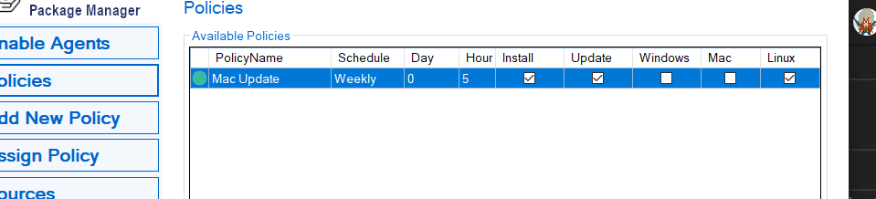

Post by strombly »
Yes that appears to be the case, as I create a mac policy and got the linux box checked.
I found and fixed where we had our SQL backwards INSERT (Windows, Mac, Linux) Values (Windows , Linux, Mac) during policy creation.
As for Linux support, If agent is available on agent to run BASH scripts & either YUM or Apt-Get is available. So we should absolutely support CentOS as it should have YUM available to it. Oracle I am less sure about but if it has (YUM or Apt-get) then yes it should be supported. We may also add down the road Zypper package manager for (SUSE).
