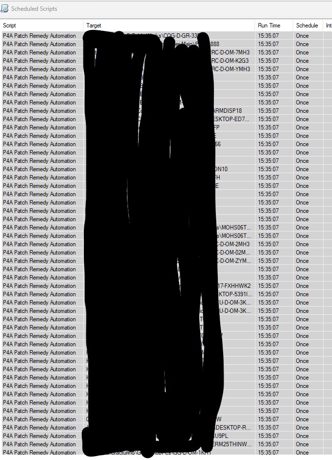

P4A Patch Remedy Automation script is running on all agents at the same starting at 3:35 p.m. time and killing my script engine.
Screenshot 2023-10-27 161155.jpg (197.61 KiB) Viewed 15317 times
Where is that scheduled? Can it be changed? I thought in ver 4 there was a setting for every 12 hours or something like that. Haven't run across a settings page yet. I updated a while ago and pretty much don't look at it, but I guess now I'm going to have to start.
Thanks,
-Joel
Re: P4A Patch Remedy Automation script is running on all agents at the same time
I am actually working on some rewrites for PR5 that will move all the script scheduling to Automated Groups. You will be able to modify the group script settings from the defaults to allow for any timing you like.
The updates are due out in the next couple of weeks, along with several other updates to PR.
