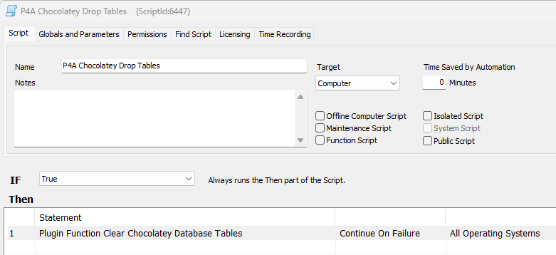

Here is what to do to get your self running
Download and Update the plugin to build -3.6.0.5 now available on site and pushing in next auto update.
Restart the DBagent and launch Control Center
Go to scripts and create a new Automate script (see Image Below). Inside script add a single line and find "Plugin Server Functions" and add it to the script. Inside the Plugin Server Functions is a Sub Function called "Clear Chocolatey Database Table". It will take no parameters and only needs to be executed once, select an available agent and execute script. Once agent says script completed "then" successfully you can proceed to restart the DBagent once again to force the tables to be recreated.
You should now have a operational plugin.
Screenshot 2023-10-17 113413.png (20.99 KiB) Viewed 198207 times
Let me know how it goes and if your table issue gets resolved.

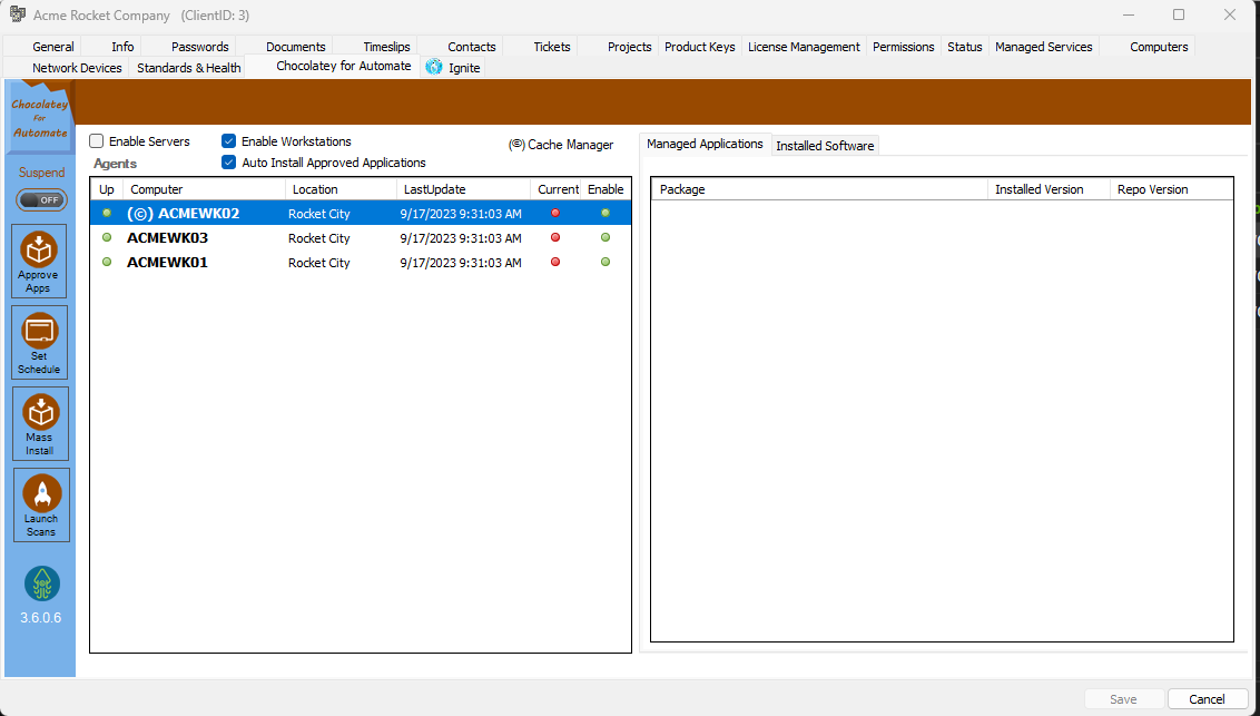

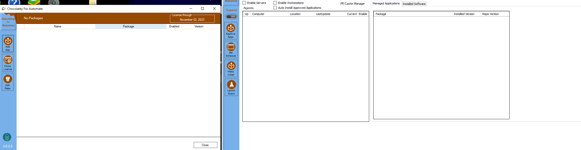

We did as instructed and all is blank now... is this something that has to re-populate tonight?
Re: C4A 3.6 updates/changes
When deleting the tables you destroyed all data held in tables. You will now need to check the boxes to enable workstations and or servers. Then set one agent as cache manager.
If this is all you do it will see agents enabled and will test Chocolatey and scan for existing packages. The caching manager during its scans will also test repo versions for all approved packages in global list.
This will bring your data back.
Next open client view and select the approved apps button and approve any apps to auto install. Got to global view to add apps to list.
Next, by default updates happen daily, this may be more often than you desire. Select the schedule button to change to your needs.
You want auto install apps to agents? Check the box and approved client apps will be installed.
Client is now configured and will operate autonomously moving forward.
Now why you don't have packages is a good question?
Let me look at that and make sure it's nothing on my side then I will help you get that back up without adding them back one at a time.
Give me 30 minutes
Please verify that your DLL in plugin manager is in fact 3.6.0.6,
I reviewed our creation of tables and all is as it should be so lets look at your case.
You mentioned you have SQL access via Habitat, Lets run a few queries to see what we actually have available to us to see the state your actually in.
In Habitat SQL execute the following statements and report your results.
Returns list of applications from master list
Select * from plugin_p4a_chocolatey_applications
Gets a list of all enabled agents
SELECT * FROM labtech.plugin_p4a_chocolatey_enable
Test for table existance
SHOW TABLES LIKE 'plugin_p4a_chocolatey_applications';
Should return table name
If these SQL queries failed then the tables are not available, manually restart the DBagent and allow it to complete the restart. Then retry queries.
If the above SQL queries did work (minus the first where no app list was returned) then the below SQL will repopulate your app list. But if table does not exist this query will also fail. Let me know if that happens.
INSERT INTO `plugin_p4a_chocolatey_applications` VALUES ('7-zip','7zip.install',1 ,'None','',''),('Java 8','jre8',1 ,'None','',''),('Flash','flashplayeractivex',1 ,'None','',''),('Google Chrome','googlechrome',1 ,'None','',''),('Adobe Acrobat Reader MUI','adobereader',1 ,'None','',''),('Adobe Shockwave Player','adobeshockwaveplayer',1 ,'None','',''),('Audacity','audacity',1 ,'None','',''),('citrix receiver','citrix-receiver',1 ,'None','',''),('Dropbox','dropbox',1 ,'None','',''),('GoToMeeting','gotomeeting',1 ,'None','',''),('iCloud','icloud',1 ,'None','',''),('InkScape','inkscape',1 ,'None','',''),('Mozilla Firefox','firefox',1 ,'None','',''),('MySQL Workbench','mysql.workbench',1 ,'None','',''),('nmap','nmap',1 ,'None','',''),('notepad++','notepadplusplus.install',1 ,'None','',''),('Putty','putty.install',1 ,'None','',''),('WinSCP','winscp.install',1 ,'None','',''),('WinPcap','winpcap',1 ,'None','',''),('WinRar','winrar',1 ,'None','',''),('WireShark','wireshark',1 ,'None','',''),('Malwarebytes','malwarebytes',1 ,'None','',''),('Spotify','spotify',1 ,'None','',''),('bginfo','bginfo',1 ,'None','',''),('Skype','skype',1 ,'None','',''),('chocolatey-compatibility.extension','chocolatey-compatibility.extension',1 ,'None','',''),('chocolatey-core.extension','chocolatey-core.extension',1 ,'None','',''),('chocolatey-windowsupdate.extension','chocolatey-windowsupdate.extension',1 ,'None','',''),('chocolatey','chocolatey',1 ,'None','','');

Just to confirm, I wiped clean all groups, searches, scripts, database tables, removed plugin, flushed out the DBagent so that all remints of the plugin were gone.
I loaded a fresh Control Center and added build 3.6.0.6 as a new plugin, enabled it and restarted the DBagent to complete install. The plugin loaded back up with everything intact and app list populated. I reconfigured client 1 as a new configuration, approving some apps, setting a weekly schedule, setting one agent to cache manager and now am watching the automation as the agents start traversing the groups via the auto join searches.
I will know here in next 24 hours if agents fully complete all tasks in front of them. Several tasks just have to past through as the agents have Chocolatey existing already. I'll let 24 hours on this client filter all the processes and verify we are completing expected jobs.
