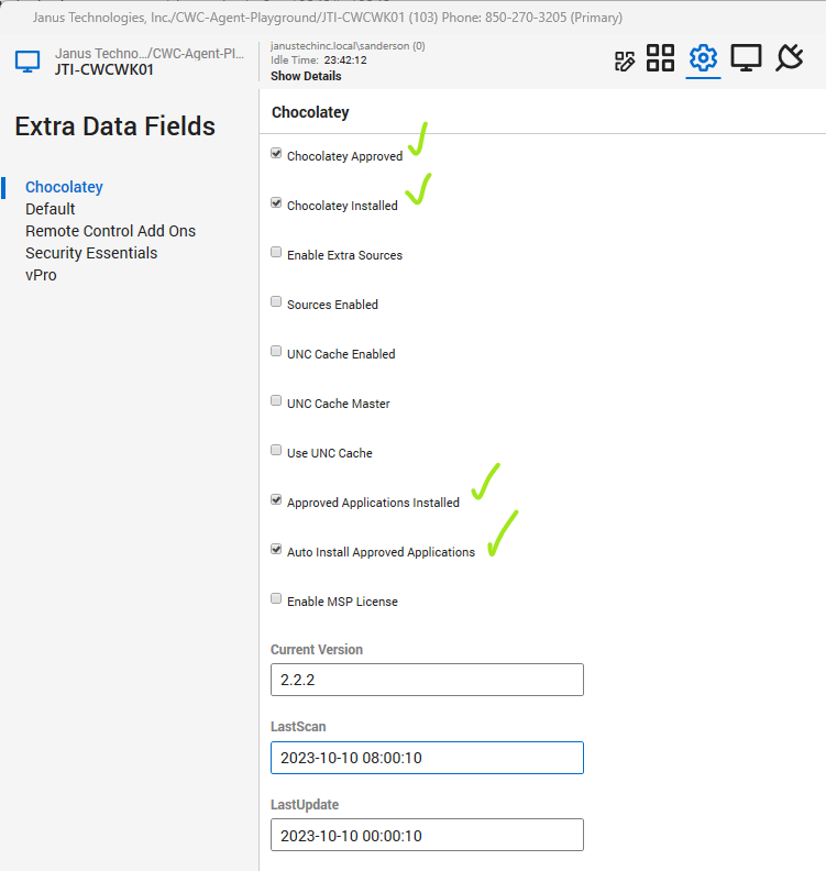

Screenshot 2023-10-10 103333.png (64.23 KiB) Viewed 14011 times
Here is an example agent's EDFs for Chocolatey For Automate.
From this view you can determine that the agent is enabled, has chocolatey installed, was set to auto install applications and completed installs.
We have the Chocolatey version currently installed and the dates of last scan and last update.
This agent should have package data displaying in client view. And below the images shows packages under management
