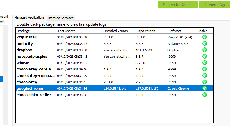

2nd and possibly a contribution factor to the former. The installed version reported in the application manager is not matching either the actual installed version, or the version reported in the software listing for that machine.
This attachment shows that chrome is installed at version 116.0.5845.141, however both on the machine and in the table provided by automate itself, the application google chrome on this machine is returning 117.0.5938.150.
Further, as you can see in the attachment, a number of software is listed as -9999 rather than the name of the application? I am unable to work out where this originates.

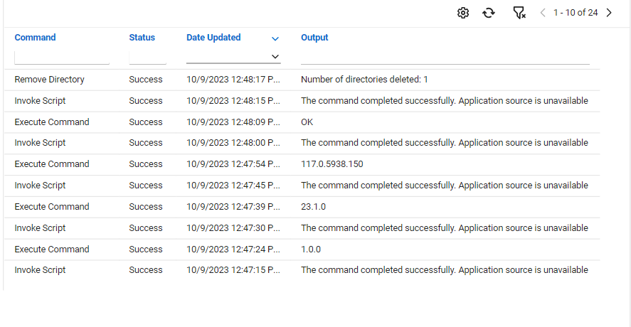

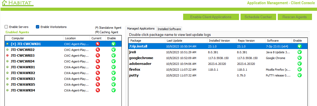

I took a unconfigure client and with a few clicks was able to go from blank apps views to present view(image below)

This was just a basic run and did not take into effect any caching or other processes. I did make a few changes in the view, got rid of the "-9999" in software column, that represented software not in list (yet).
Steps I took:
- Enabled workstations under client view
- Approved a handful of applications in the clients approved apps list
- Set test agent as Stand Alone
- Ran "Update Now" which is same command automation will run.
Also adjusted Managed Apps button, it was not aligning as expected.
See if this update helps any..
