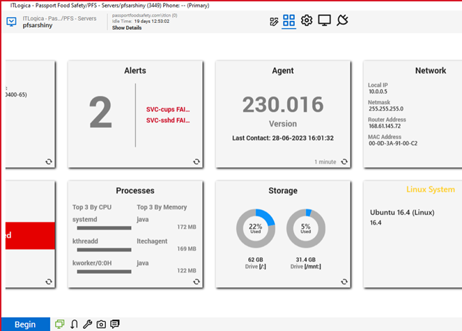

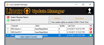

Can you please share the steps for us to be able to Patch few of the Linux servers using LUM as when we are clicking on Open Agent Console in LUM then it opens up the dashboard for the machine.
Can you please share the more details?

I would like to see a list of packages available, the current version installed and the available version. Then I would also like to see a clear ability to push updates manually from main console.
There is already a manual update function under the agents console -> plugins -> Linux Update Manager.

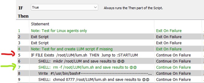

Simply open the agent console and select "Begin" to open menu strip, under tools will be run command, select this function. In newly made command window paste the following command to remove file.
rm -f /root/LUM/lum.sh
You can also edit the LUM Maintenance Services script in the /scripts/maintenance/ script directory
Disable line 5 and enable line 7 will force the script to update on every run of script. This is fine but adds a few steps to script. Once your comfortable that all changes are made then you can revert your changes and speed up the script by 3 commands.
Green: Enable Function
Red: Disable Function
Screenshot 2023-07-03 114301.jpg (57.11 KiB) Viewed 232116 times

I just installed this plugin (build 1.0.26) and am running it for the first time. On one of my Linux systems it scans for updates fine, but on another one the LUM Maintenance Services script fails. Output shows
packages -> [sh: 1: /root/LUM/lum.sh: not found]
I tried disabling Step 5 and enabling Step 7 in the script to see if that would help, but same result on rescan. Any suggestions? I'm on Automate 2023.5, the working scan is running on Debian 11.0 and the failing scan on Debian 9.13.
