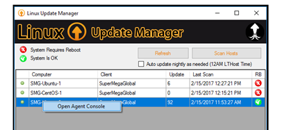

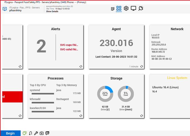

Can you please share the steps for us to be able to Patch few of the Linux servers using LUM as when we are clicking on Open Agent Console in LUM then it opens up the dashboard for the machine.
Can you please share the more details?

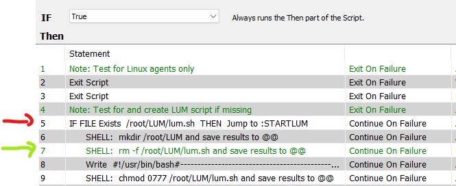

This fix requires that the agent replaces the LUM.sh file. If after update and a full scan of the (YUM) agents the view remains the same and versions are swapped then you will need to manually remove the file and rerun scan. The scan will see the file is missing and will replace it with new file.
Simply open the agent console and select "Begin" to open menu strip, under tools will be run command, select this function. In newly made command window paste the following command to remove file.
rm -f /root/LUM/lum.sh
You can also edit the LUM Maintenance Services script in the /scripts/maintenance/ script directory
Disable line 5 and enable line 7 will force the script to update on every run of script. This is fine but adds a few steps to script. Once your comfortable that all changes are made then you can revert your changes and speed up the script by 3 commands.

I just installed this plugin (build 1.0.26) and am running it for the first time. On one of my Linux systems it scans for updates fine, but on another one the LUM Maintenance Services script fails. Output shows
packages -> [sh: 1: /root/LUM/lum.sh: not found]
I tried disabling Step 5 and enabling Step 7 in the script to see if that would help, but same result on rescan. Any suggestions? I'm on Automate 2023.5, the working scan is running on Debian 11.0 and the failing scan on Debian 9.13.
Re: Patching a few Linux boxes
Well the error says it cant find the file written in line 8.
So first test to see if line 6 actually created the directory "/root/LUM"
command line execute
ls -al /root
Should list all items in the /root directory, see if LUM exists.
Next if LUM exists see if /root/LUM/LUM.sh exists
ls -al /root/LUM
If neither of these exist or only one exists then you have a permissions problem writing to that agent. Open up agent console and select to run command line tool.
Execute
whoami
and see what user you report as. It should be "root"
post findings here...
Hmm.
Then why would script report ([sh: 1: /root/LUM/lum.sh: not found]) is the lum.sh set as executable?
on line 22 we execute
/root/LUM/lum.sh SCAN
If you run this on agent what is output?
