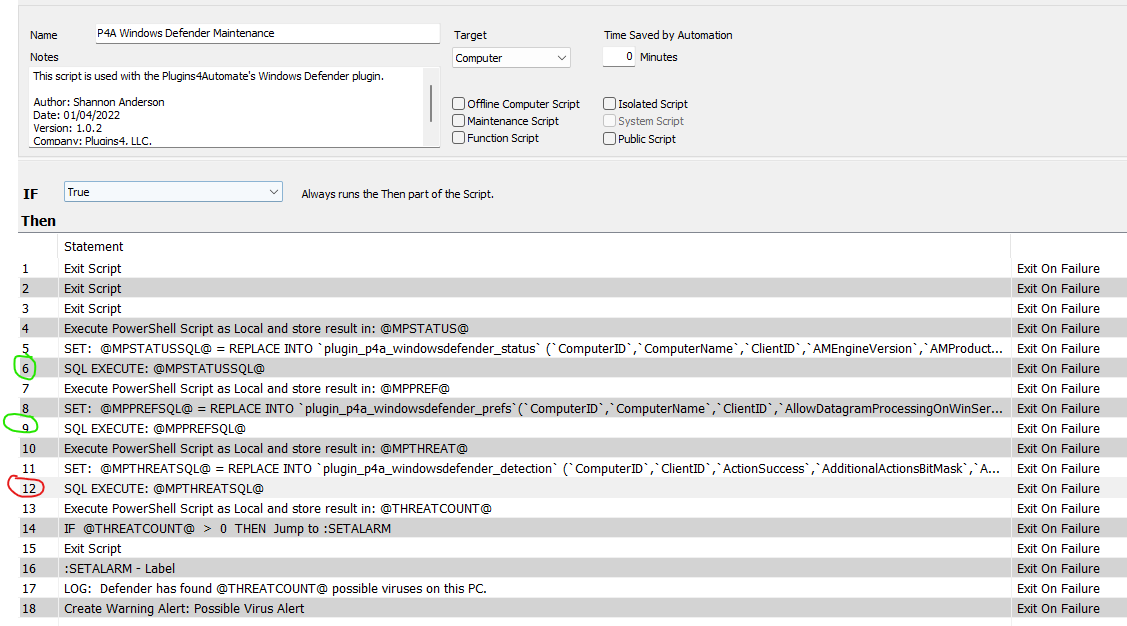

Ok I had a chance to review the script and fail points.
Here is the skinny:
Each SQL Execute is dependent on the success of the SQL query that goes before it by design.
There are 3 main steps to getting the data about Defender AV,
Step 1: Get Defender Status, If successful save to SQL and move to step 2
Step 2: Get Defender preferences, id successful save to SQL and go to step 3.
Step 3: Get any threat data and save to database.
You are failing to get threats because you have none to get. So SQL execute returns nothing and fails out. To resolve the error outs we should set the Exit On Failure to Continue on Failure.
All failures are ok and can be ignored. We either get the data or not, if not then Windows is not reporting anything.
Screenshot 2023-05-24 135535.png (65.58 KiB) Viewed 49327 times
Re: P4A Windows Defender Maintenance Failing
Posted: Wed May 24, 2023 6:18 pm
Ok to immediately resolve your issue set the following lines in the script to Continue on Failure.
line 4, 6 and 7
line 9,10, 12 and 13
Screenshot 2023-05-24 141829.png (44.98 KiB) Viewed 49327 times
I made the updates on my side and will post them with the next release of plugin.

by bfalco
thank you that resolved the issue.
