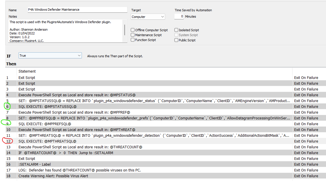

I am seeing this on all agents, ones that only have defender as AV and others that do have another AV app.
Here is the log
he Script(6345) failed in the Then section at step 12. The reason: SQL Execute failed processing query
Script: S6345 - Starting at Server Time: Thursday, May 4, 2023 8:12:50 AM
IF F1 T: 0.2449958
L4 F235 T: 0.4359934
L5 F20 SetType(P1):1 Parameter(P2):'REPLACE INTO `plugin_p4a_windo...' VariableName(P3):MPSTATUSSQL T: 10.4172899
L6 F67 Sql (P1): 'REPLACE INTO `plugin_p4a_windowsdefender_status` (`ComputerID`,`ComputerName`,`ClientID`,`...' T: 10.5342944
L7 F235 T: 10.7372919
L8 F20 SetType(P1):1 Parameter(P2):'REPLACE INTO `plugin_p4a_windo...' VariableName(P3):MPPREFSQL T: 20.5936218
L9 F67 Sql (P1): 'REPLACE INTO `plugin_p4a_windowsdefender_prefs`(`ComputerID`,`ComputerName`,`ClientID`,`Al...' T: 20.665613
L10 F235 T: 20.7306845
L11 F20 SetType(P1):1 Parameter(P2):'REPLACE INTO `plugin_p4a_windo...' VariableName(P3):MPTHREATSQL T: 22.8234359
L12 F67 Sql (P1): 'REPLACE INTO `plugin_p4a_windowsdefender_detection` (`ComputerID`,
`ClientID`,
`ActionSucc...' T: 22.8254373

Says fails line 12 SQL Execute @MPTHREATSQL@
Any help is appreciated

Ok I had a chance to review the script and fail points.
Here is the skinny:
Each SQL Execute is dependent on the success of the SQL query that goes before it by design.
There are 3 main steps to getting the data about Defender AV,
Step 1: Get Defender Status, If successful save to SQL and move to step 2
Step 2: Get Defender preferences, id successful save to SQL and go to step 3.
Step 3: Get any threat data and save to database.
You are failing to get threats because you have none to get. So SQL execute returns nothing and fails out. To resolve the error outs we should set the Exit On Failure to Continue on Failure.
All failures are ok and can be ignored. We either get the data or not, if not then Windows is not reporting anything.
Screenshot 2023-05-24 135535.png (65.58 KiB) Viewed 49321 times

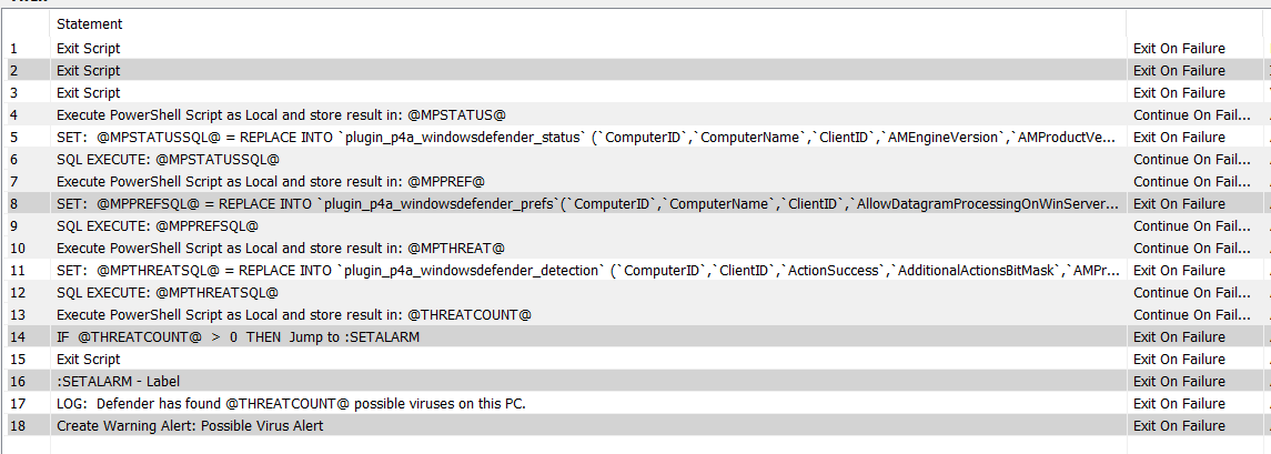

Re: P4A Windows Defender Maintenance Failing
Ok to immediately resolve your issue set the following lines in the script to Continue on Failure.
line 4, 6 and 7
line 9,10, 12 and 13
Screenshot 2023-05-24 141829.png (44.98 KiB) Viewed 49321 times
I made the updates on my side and will post them with the next release of plugin.

Post by bfalco »
thank you that resolved the issue.
