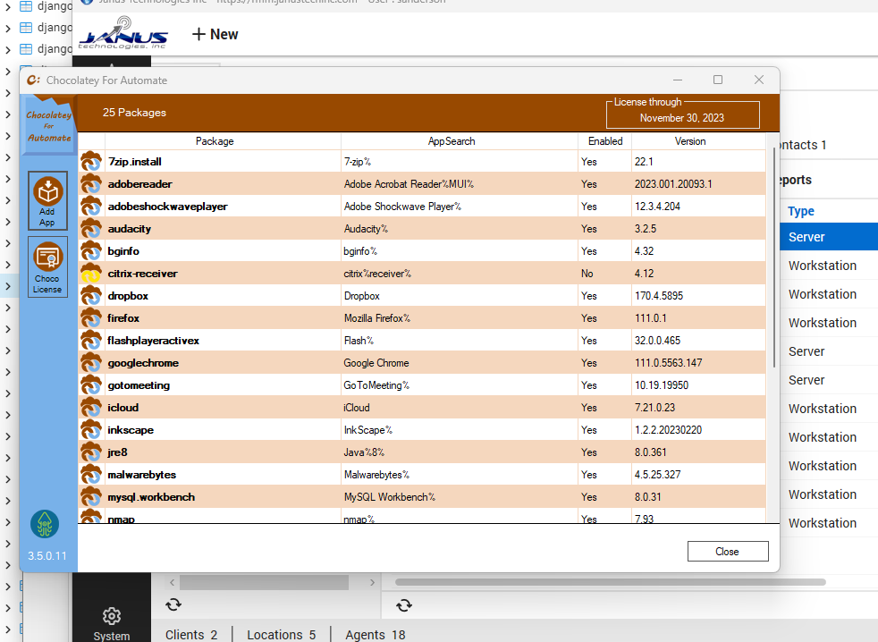

Screenshot 2023-04-04 150120.png (130.64 KiB) Viewed 6605 times
Its In C4A, Under the main tools menu, Global application policy, If enabled should be pushed down to agents.
