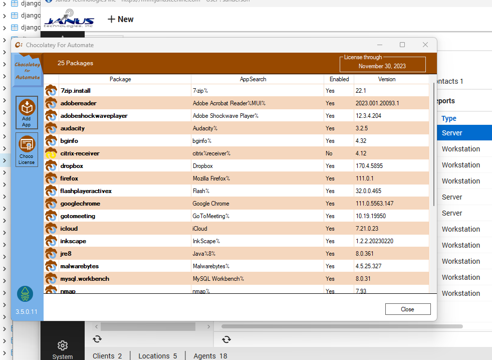

Anyway while testing this I could not find an option to set some kind of default software for a cleint that will be installed on each computer. I took it for granted there would be an option like in C4L to set approval lists per client.
When searching the documentationI did not find a feature like this in App Genie, C4A or Habitat.
Screenshot 2023-04-04 150120.png (130.64 KiB) Viewed 5953 times
Its In C4A, Under the main tools menu, Global application policy, If enabled should be pushed down to agents.
