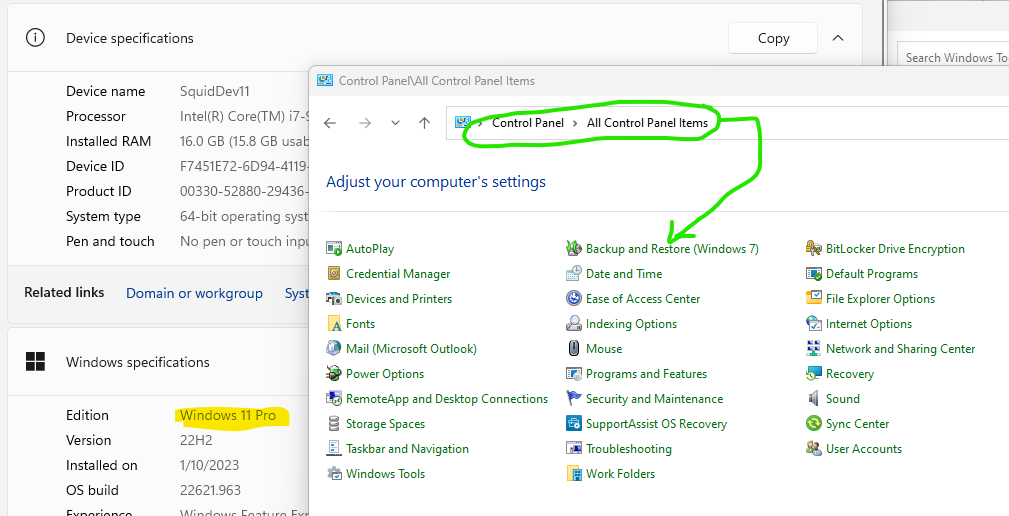

The Windows 7 backup tool is under all control panel items as seen in image below..
Screenshot 2023-01-18 134352.png (83.77 KiB) Viewed 31797 times
