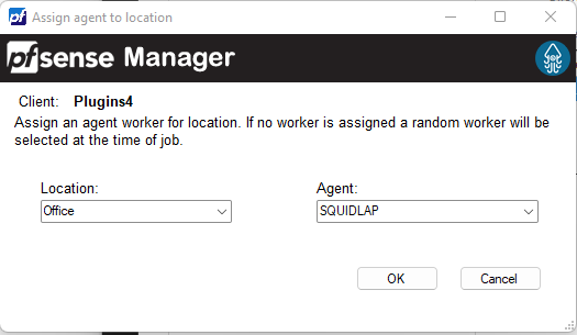

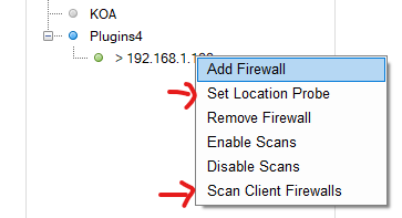

As for your request, we have added it to the code base and it is available in build 2.0.0.2 available here
Build 2.0.0.2
What's new:
You now have 2 new items in menu. Manage what agents are used at what locations and a client scan button to allow you to force a scan now.
The set Location and agent menu item will bring you to a control that will allow you to select any location for client then any agent under that location.
Re: Firewall Information Not Populated
Posted: Mon Nov 28, 2022 8:14 pm
by ckatri
Thank you, I was just checking it out, two notes:
1. The new "scan client firewall" does not seem to work
2. the execute command does not respect the new agent selection
