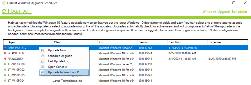

So since you must have user intervention, I have added a new menu item to the windows 10 upgrade tool to push windows 11 to logged on consoles only. This function does not do any pre testing of the agent to see if it is compatible with Windows 11. So you will need to do your do diligence.
This allows you to select multiple agents at once and send a script to execute (now) the Windows 11 upgrader via windows upgrade assistant. The script verifies its running on Windows 10 only and that a user is logged into a console of the agent. It then redirects the execution of a POSH script from the users console which will launch the installer and have then accept the EULA. Once that is properly accepted the install will continue silently to completion.
Screenshot 2022-10-02 123617.png (47.22 KiB) Viewed 26497 times
Upgrade to Windows 11
Available in Habitat build 1.0.1.30
This is a run now function. Highlight one or more agents from agent list and select this menu item from the main menu.
It will verify agent is windows 10 and that a user is logged in to a console. It will then execute the installer on that console so that user will see the EULA to accept. Once user accepts EULA the install will continue silently.
