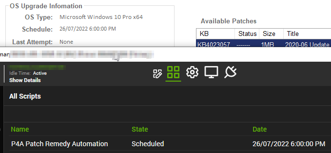

When I run the schedule OS upgrade on a different day other than today. It never shows a schedule script that will run.
Is this normal?
Attached I have a schedule OS update on the same day which shows the script will run on the correct times

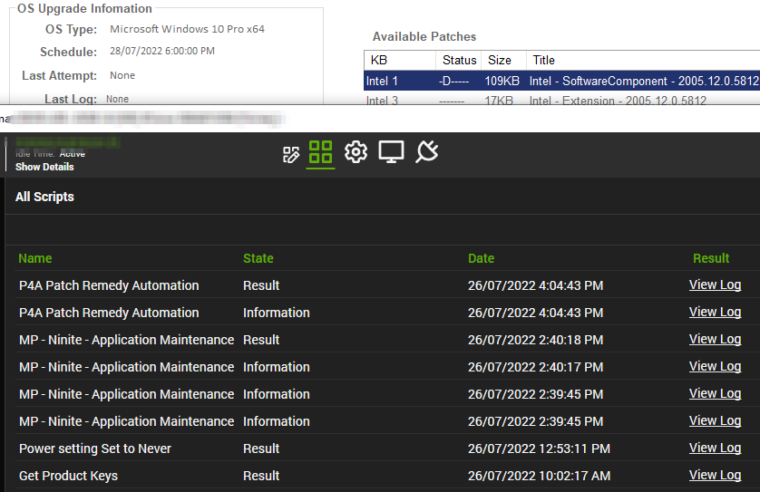

I have also attached the problem when I schedule on different day it doesn't show that a script will run
Schedule OS Upgrade Not running

- Not working different day.png (48.8 KiB) Viewed 9076 times
- working same day.png (18.16 KiB) Viewed 9076 times

It posts the scheduled script the day of the schedule at 12 AM for what ever time you set it for that day.
Example: I set an Upgrade for 10 days from now at 8:00 AM.
Ten days from now at 12:00 AM the schedule will be created for that action for 8:am that day. There will not be a pending script sitting in the queue waiting for ten days to execute.
But if you schedule a upgrade for 10 PM the same day your on then the schedule is created at the time you set the schedule.
