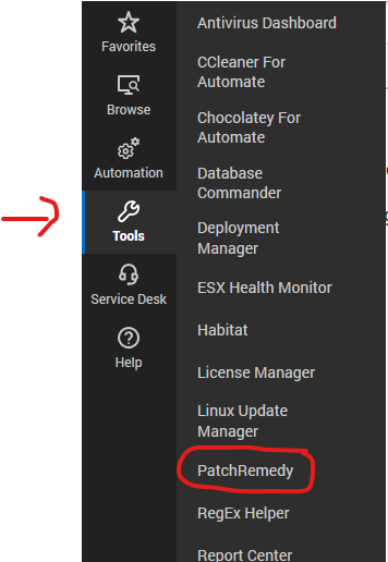

Then Patch Remedy will be in the tools menu
Screenshot 2022-06-21 150537.png (37.46 KiB) Viewed 7102 times

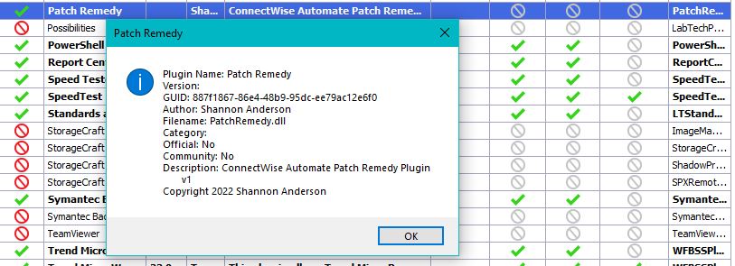

I followed your instructions exactly but it hasn't helped unfortunately. The version I was initially using was 1.0.5.10 however i tried again with the one you linked. When I updated the plugin it said the GUID was different and I told it to go ahead. I restarted the DB agent restarted the CC and it still looks like this
I selected About so you could see the details in there.

OK if you received a Mismatched GUID pop up box then you have upgraded the wrong plugin.
I would test to make sure that the very first plugin in your plugin manager has not been over written with the new DLL file
Please visit this post for a better explanation and how to fix that issue.
viewtopic.php?t=5521
