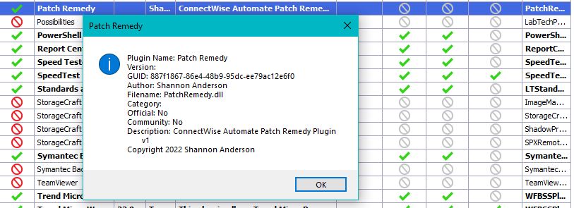

We were a v4 customer for a number of years. I followed the upgrade post (buy v5, cancel v4 sub) and got the download link through. I went into the plugin manager in Automate and removed the previous version, closed out of CC, went back into it again and installed the new plugin version using your docs for how to install plugins. I have restarted CC a few times, restarted the database agent, restarted IIS (we are a cloud customer so I can't easily restart the server).
I can't see the PR plugin anywhere in the CC, if I check the plugin status I see the status shown in the attachment i.e. no green ticks
PR 5.JPG (16.62 KiB) Viewed 7099 times
Can you help me get this resolved please?

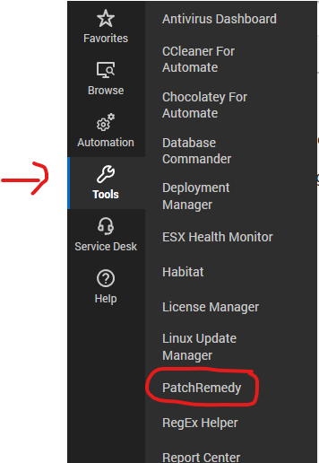

Re: Upgrade from v4 to v5
Looking at your image I do not see a version number for Patch Remedy.
So here is link to download Build 1.0.5.10
https://delivery.shopifyapps.com/-/a033 ... 35fa38e8ca
Download a fresh copy and extract the dll, unblock it in the properties of file before attempting a install.
Select the Patch Remedy from the patch manager and then select to update plugin from menu. Update the DLL, restart the DBagent, logout and back into control center.
After login the plugin manager should look like this
Screenshot 2022-06-21 150633.png (10.17 KiB) Viewed 7096 times
Then Patch Remedy will be in the tools menu
Screenshot 2022-06-21 150537.png (37.46 KiB) Viewed 7096 times

Hi there,
I followed your instructions exactly but it hasn't helped unfortunately. The version I was initially using was 1.0.5.10 however i tried again with the one you linked. When I updated the plugin it said the GUID was different and I told it to go ahead. I restarted the DB agent restarted the CC and it still looks like this
I selected About so you could see the details in there.
Oliver
OK if you received a Mismatched GUID pop up box then you have upgraded the wrong plugin.
