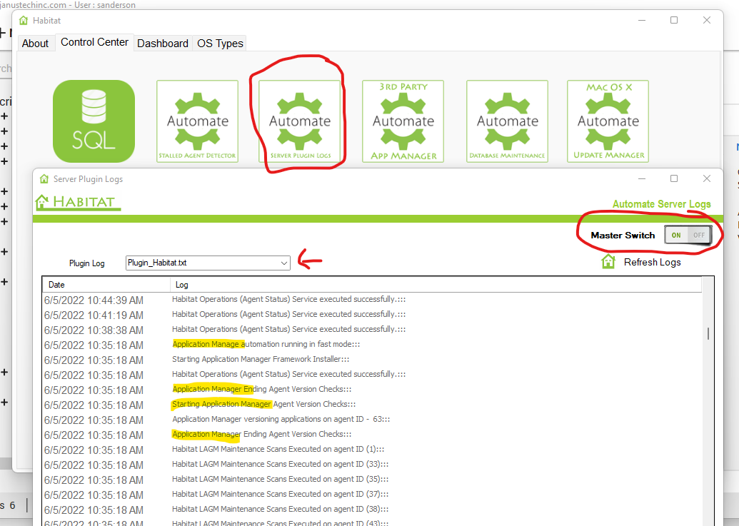

Sorry That should of been Habitat Application Manager script not Chocolatey For Automate... The two tools are very similar and do the same thing so I some time cross them when talking about them.
So once a week on that day, starting at midnight you should start seeing in the logs that automation to update the agents launches.
You can check the server logs here by pulling the Habitat log. Then check the agents script logs to see the update data on that agent.

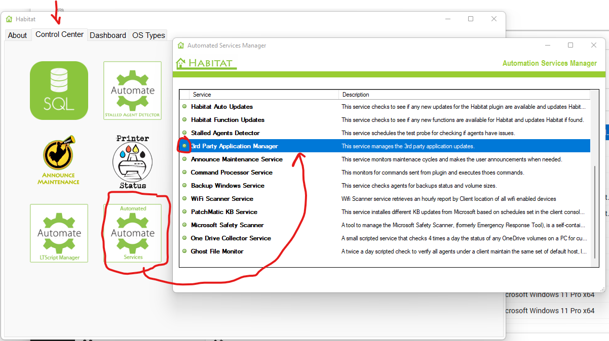

It should update / install only on the day set in weekly schedule, but will collect version info daily.
I should state that you should verify that you have the Application Manager service running.
