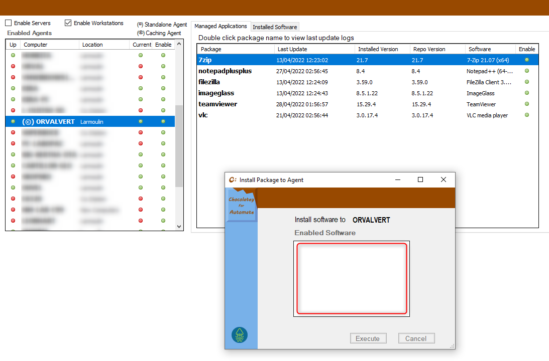

We are new to this plugin but so far, we've been able to
- Enable packages globally
- Scan agents for packages, the "managed applications" list is filled with what's installed on the device
- Set the cache location
- Update the cache from a caching agent : the cache folder is filled with all the enabled package
But when we want to use the "Install Software from Repo Cache", on right-click menu on an agent, the list of "Enabled Software" is empty thus we can't select any software to install from cache.
Even when we execute it on the caching agent, the list is empty.
What are we missing and what could cause this list to be empty ?

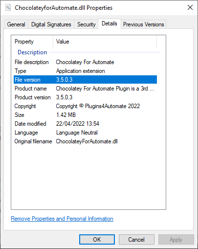

The plugin is up-to-date to version 3.5.0.4 on the server side but stays on the 3.5.0.3 when we launch the Automate client.
We tried to delete de .dll from the local cache but it keeps re-download the 3.5.0.3 version.
We wanted to try to override the local .dll on the client side but we didn't receive any confirmation link with download links and we can't find those links on the website neither.

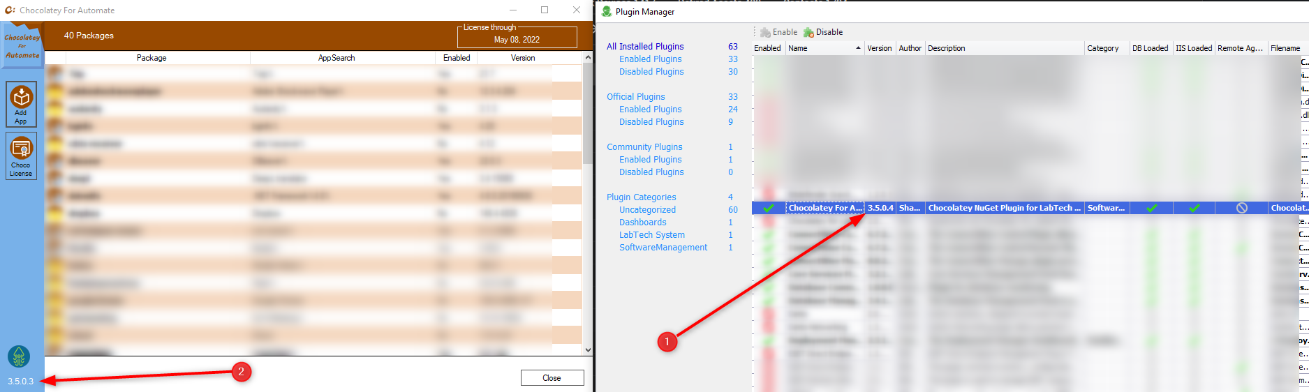

What is the version number of your ActiveDriectory plugin in the plugin manager? Is it also 3.5.0.3? You might have a duplicate plugin over written if you are seeing 2 or more Bitlocker tabs in any one client.
Next if server shows 3.5.0.4 but control center shows 3.5.0.3 do the following.
Close the control center, Navigate to C:\ProgramData\Labtech Plugins\ and delete all folders listed under this directory. No worries they will be replaced on next login of Control Center.
Now log back into control center and let it rebuild the DLL files here.
Retest the versions and see if you are now seeing the correct build number.

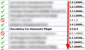

Version shown in the plugin manager is 3.5.0.4.
Version shown in the Chocolatey For Automate Plugin is 3.5.0.3
We already tried to close the Client, empty the directory C:\ProgramData\Labtech Plugins\ and relaunch the client.
The .dll plugin files are indeed downloaded again at launch but the file "ChocolateyforAutomate.dll" stills stays in the version 3.5.0.3.
I attached all the screenshots to reflects the situation.

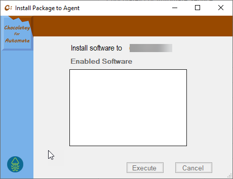

Unfortunately, we still have an empty package list in the window that show up when we select "Install Software From Repo Cache" option.
Cache is correctly updated though.
Any idea where could be the issue ?

Oh jees!
Called the older version of the table, brain fart!
Here is the fixed version..

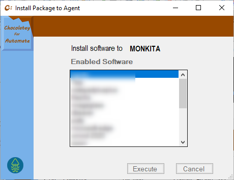

Version 3.5.0.6 seems to work like a charm
I'll do more tests but so far so good.
Thank you very much for your assistance.
