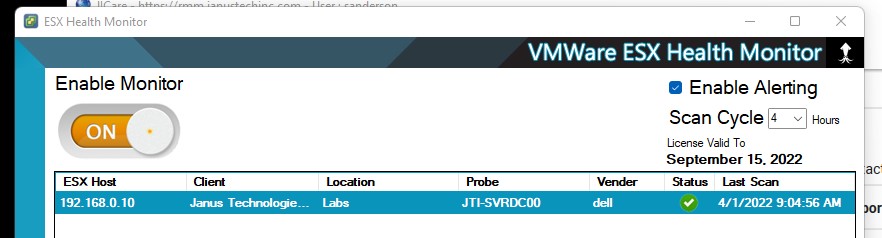

Posted: Fri Apr 01, 2022 1:12 pm
If you open the the main ESX Monitor link from the tools menu, Does it show valid?
Screenshot 2022-03-25 085831.jpg (49.55 KiB) Viewed 30243 times

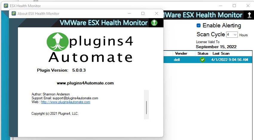

Posted: Fri Apr 01, 2022 1:16 pm
Also, just so we are on the same playing field.
What does your version say if you click the small squid icon in to of main window?
Screenshot 2022-03-25 085831.jpg (71.14 KiB) Viewed 30243 times
