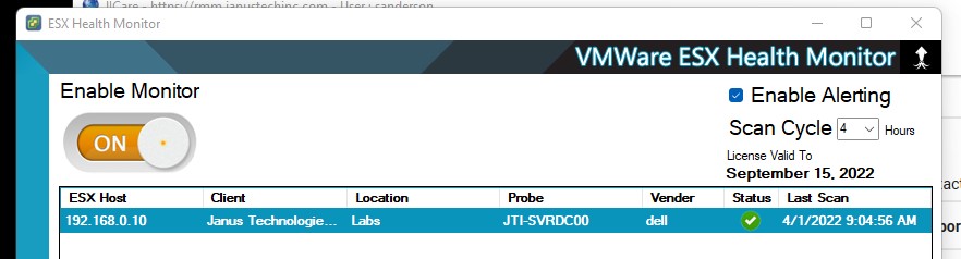

If you open the the main ESX Monitor link from the tools menu, Does it show valid?
Screenshot 2022-03-25 085831.jpg (49.55 KiB) Viewed 30229 times

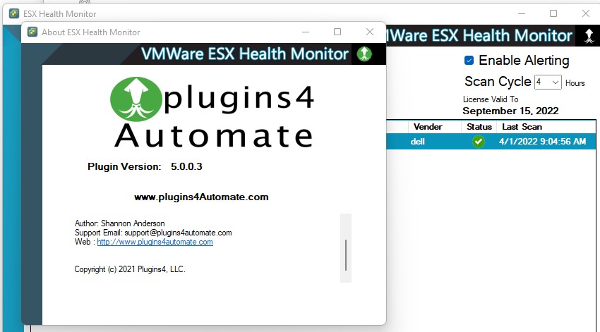

Also, just so we are on the same playing field.
What does your version say if you click the small squid icon in to of main window?
Screenshot 2022-03-25 085831.jpg (71.14 KiB) Viewed 30229 times
